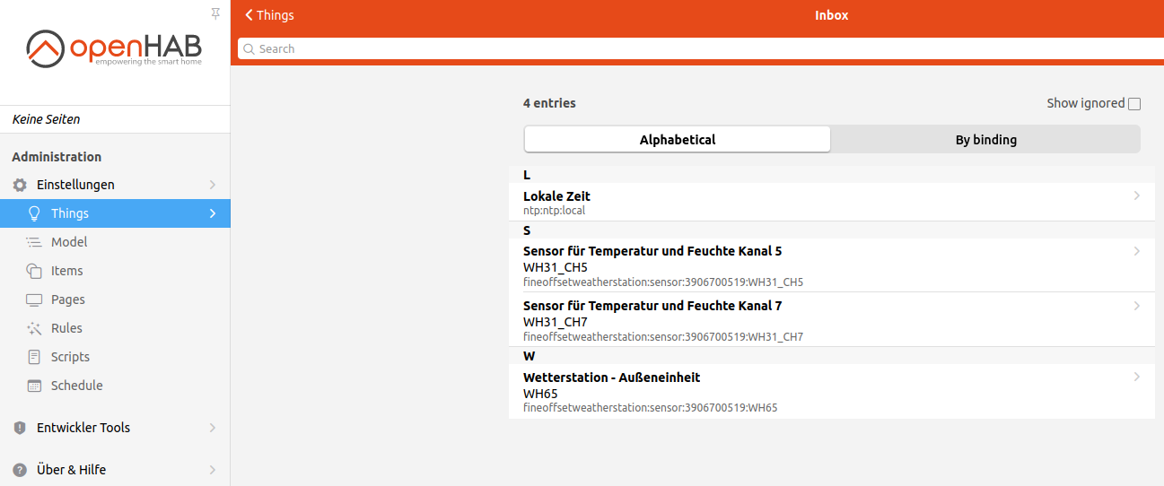

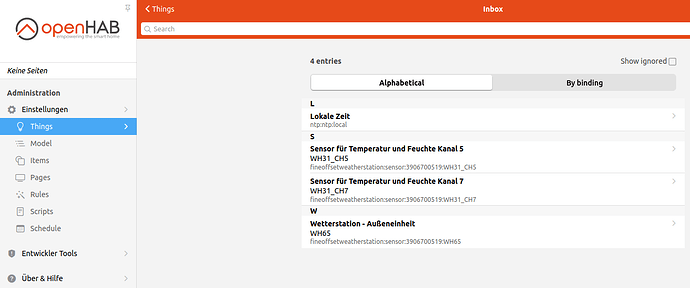

I mean the internal sensors of the gateway do not show up in the INBOX of the Things (in contrast to the other available sensors).
Can you do me a favor and provide me with the complete trace log, especially the one from the executeCommand. I need the response from CMD_READ_SENSOR_ID_NEW.
Thank you, the binding (3.3.0-SNAPSHOT) is working smooth and flawlessly with my GW1100!
The internal sensors to not show up in the INBOX because there is no separate “sensor” thing for them. Just add them as shown in the documentation.
