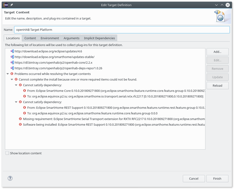

Anyway, I thought I don’t really want to upgrade my productive environment. So I looked in your repos what branches are available and saw the 2.2.x branch. Thus I switched to this older branch. But now, I could not update the target platform. It fails to find a bunch of org.eclipse.smarthome features and plugins.
Hence, I just switched back to master. Now, I could successfully update/reload my target platform and most projects don’t have error-markers, anymore.
