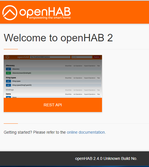

Ok found what was the problem… plugins are not included by default in run configuration.
To solve this, go to Run --> Run configurations --> select openHAB_Runtime --> Plug-ins --> use the button “Add Required Plug-ins”
That’s it…
