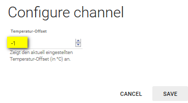

thank you for your answer. You write that the offset is a readonly value. How can I get the value in the avm fritzbinding. Is there a special Channel/Parameter (temperature, actual_temp)? I only get the same temperature for both channels.
temperature channel, configuration parameter
I don’t find this configuration. I have only these options.
Which OH version do you use?
openHAB 2.3.0 Release Build
Ah, I see. Then you will have to wait for it. ;-). You need snapshot or milestone build for seeing it.

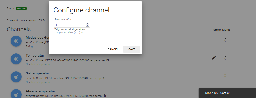

When trying to change(save) the channel i get an error 409
When trying to change(save) the linked item i get an error 405

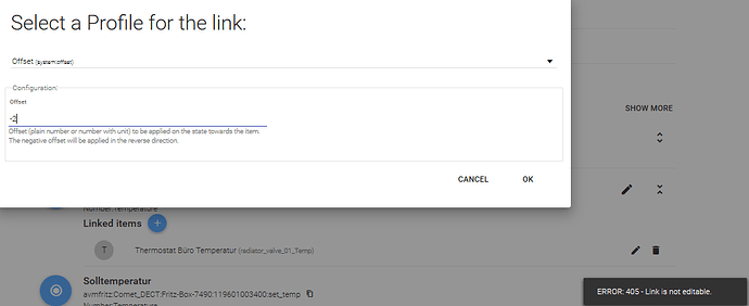

The errors occurring in Paper UI while editing Channels or Items are valid because you set up your stuff in a textual configuration. It is not possible to do both at the same time.
Yes, I understand. The link is for the ESH framework which is a little bit more technical than the OH2 documentation. We are working on a OH2 specific part for the profiles. You can find a preview here.
Let’s try to apply the offset profile in your setup. I think an Item should look like this:
Number:Temperature radiator_valve_01_Temp "Thermostat Büro Temperatur [%.1f %unit%]" <temperature> (EG_Buro,gRtSoll,gRFritz_01) { channel="avmfritz:Comet_DECT:Fritz-Box-7490:119601003400:temperature"[profile="offset",offset="<VALUE>"] }
The part <VALUE> has to be replaced with your preferred offset.

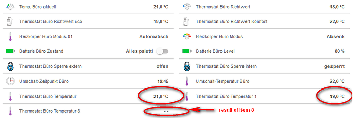

I made the following tests with items 1 to 8 and that’s the result:
>>>>>>>>>>>>>>>>>>>>>>>>>>>>>>>>>    :Item 1

Basic-UI:
Fritz-Box:
But it was not quite the result i expected. I thougt i get the delta as in paper ui shown:
Anyway, but what i’m noticed is that the temperature channel always shows the offset-temperature. When using the offset-profile i have something like a “twin-offset”, as in the screenshot of the basic-ui.
What do you think ?
rgds, Peter
Looks like Item 1 is the way to go. :+1:
True. The FRITZ!OS interface returns the offset value for the temperature whereas in FRITZ!OS the modified temperature is shown.
True again. We have two different offset values. First one is FRITZ! offset, editable in FRITZ!OS, but not modifiable via FRITZ!OS interface. Thus a read-only value and for information only in the channel configuration. The second one is the OH2 (or more the ESH) framework profile value. Adjustable via UIs - except when you are using textual configuration. So, yes we have multiple options available how to handle offsets. Now you have to decide which one you prefer :wink:.
