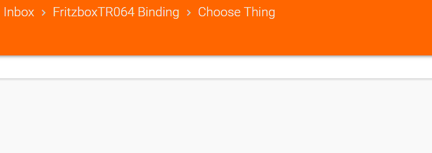

I can configure the binding itself but I can not search things. I click on the ‘+’ and then select the appropriate binding and then can not do anything. We can see in the following screenshot.
I can not get any further here.

The big confusion is that this binding is an OH 1.x version binding. There are no Things in OH 1.x version bindings. That is one of the biggest differences between OH 1.x and OH 2.x. OH 1.x bindings do not support Things and therefore do not support automatic discovery.
I’m surprised you were able to do as much with this binding as you already have in PaperUI. PaperUI only really supports OH 2 bindings.
To use this binding, you will need to create a .items file and manually define Items as documented here.
