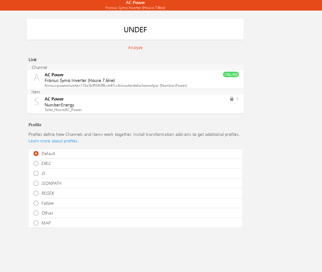

(DOESNT WORK)
// House Inverter //
Number:Energy Solar_HouseAC_Power      "AC Power" (gSolar_ACPower)                     { channel="fronius:powerinverter:172a3b9554:e4b3052ae0:inverterdatachannelpac" }
Both definitions are the same yet the OpenHAB UI says UNDEF for the house inverter, despite all other channels working OK
openhab> openhab:status Solar_HouseAC_Power
UNDEF
openhab> openhab:status Solar_GarageAC_Power
1187 W
openhab>
Any thoughts? Thanks

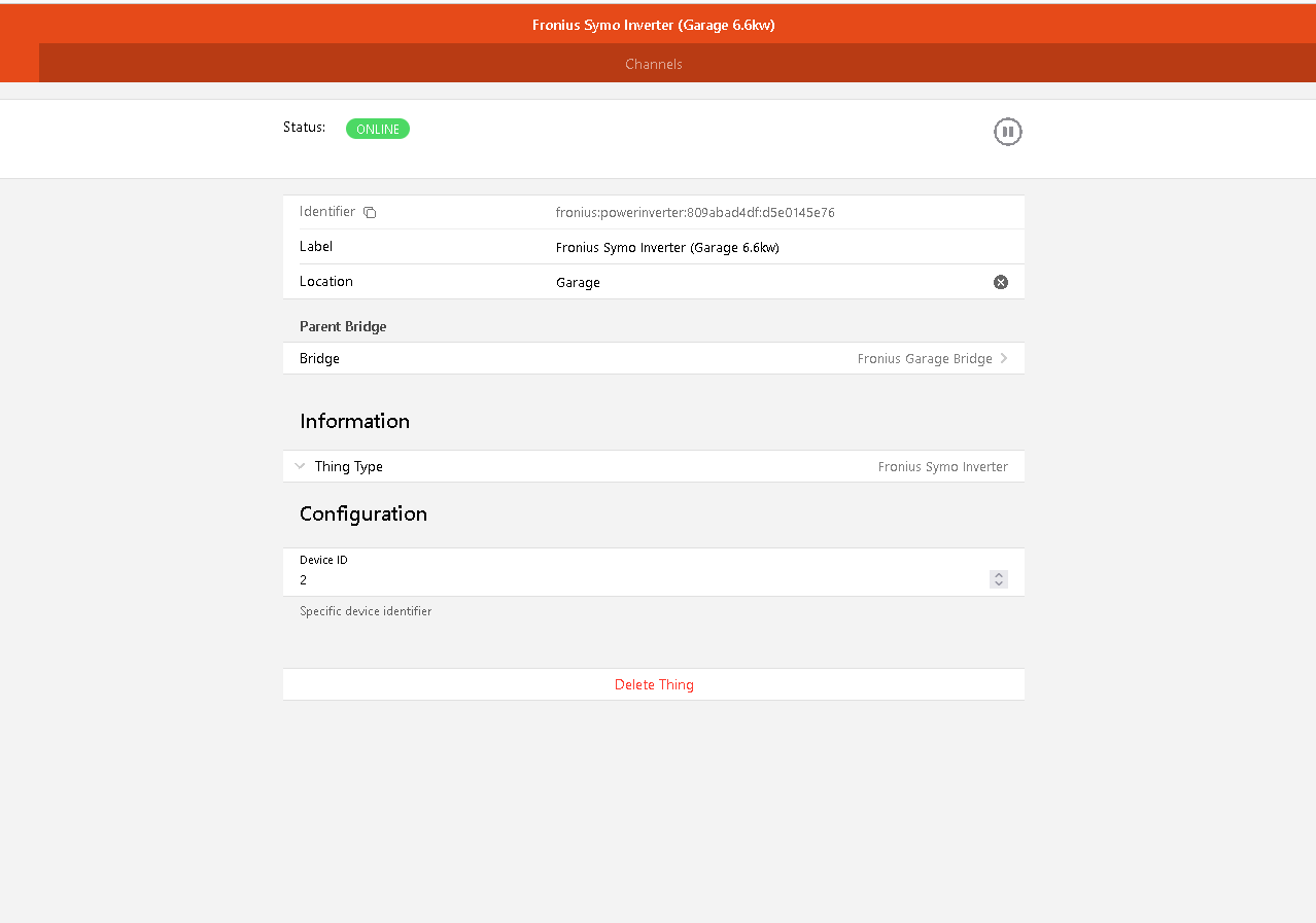

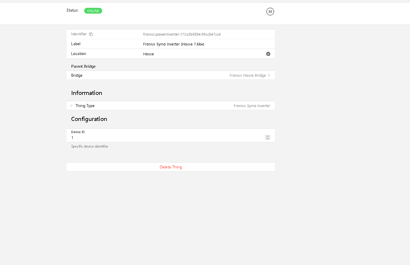

What are the thing definitions on both of those?
Fails but all other channels are working fine on it
Works

I just noticed that your channel id doesn’t match the thing id.
Where is this e4b3052ae0 ?
I think youre looking at the Garage, my issue is with House
The items match - 99ccb is the problematic thing
I dont see e4b3052ae0
Let’s try a different approach. Delete whatever it is that’s not working and re-create it.
Same issue, recreated the Inverter and the Bridge, all channels populate but the AC Power inverter channel, it comes up as UNDEF
Why is the item Number:Energy? Shouldn’t it be Number:Power?
The other inverter (ive got 2 x Fronius units, 1 smart meter) works fine and has for years on Number:Energy
Changing it didnt fix the issue :frowning:
I still suspect there’s a mis configuration somewhere.
Can you post the config (not screenshots) of the bridge, thing and item? Are they all configured using .things / .items files? If so, post them here
Ive just deleted the item from the and created it via a different name via the GUI and away its working! Weird :slight_smile:
I think ill just move my items over to the GUI configuration now
Thanks Jim!!
