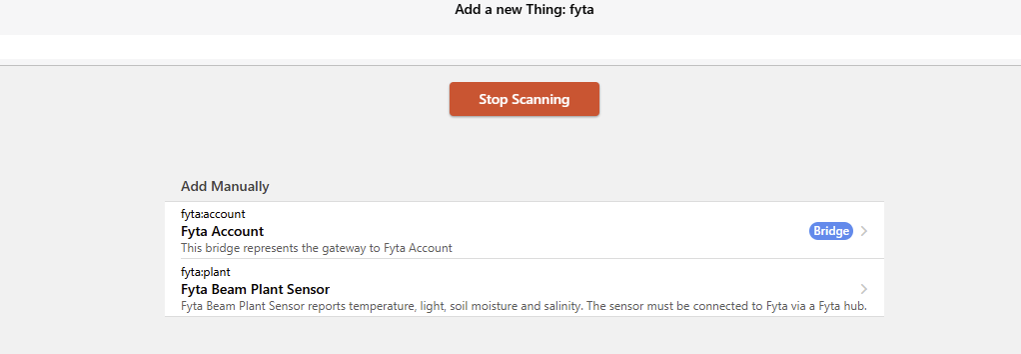

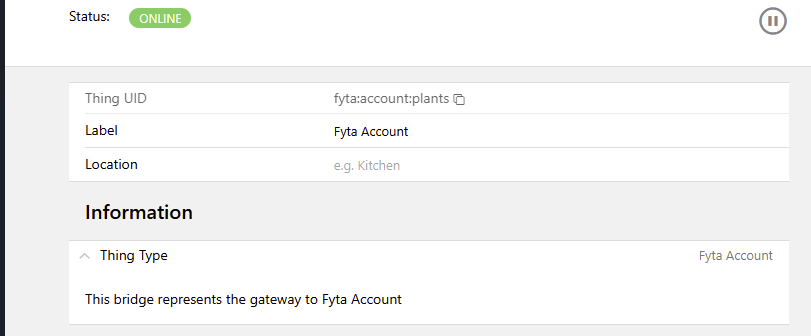

I create a FYTA bridge/thing OK and goes online
Then add new thing and scan but nothing every found… just says scanning indefinitely.

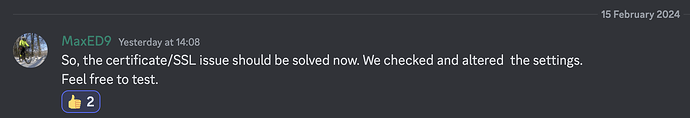

The TLS/SSL certificate on their API is broken again. HA and Homey users reports the same.
Seems like a similar issue they had 2 years ago; Fyta Beam plant sensor binding [4.0.0.0;6.0.0.0) - #6 by seime
The best thing to do is to have the FYTA devs fix their server, you can reach them on this discord channel: Discord
Thank you @seime !
They confirmed there have been problems updating their certificates, but they fixed it now and I can confirm, it’s working again after setting the FYTA bridge to offline and setting it to online again. :+1:
