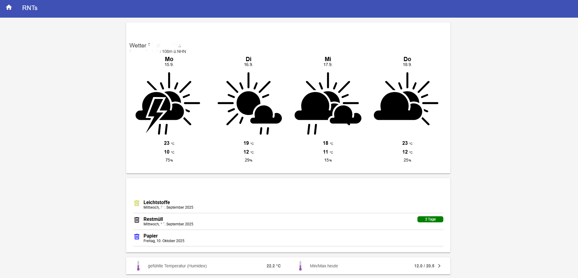

Group and Items
Create the group gGarabgeCollection and for each collection an own item. The following example is for an item file but you kan create this also in MainUI. Its importend to assoziate each collection item with group gGarbageCollection
Group                                     gGarbageCollection
DateTime  garbage_collection_yellowbin "[%1$tT, %1$tY-%1$tm-%1$td]" (gGarbageCollection) {channel="icalendar:eventfilter:xxx:yyy:result_0#begin", stateDescription="" [pattern="%1$tA %1$td.%1$tm.%1$tY"], widgetColor="#cbcb36", widgetText="Leichtstoffe"}
DateTime  garbage_collection_bluebin   "[%1$tT, %1$tY-%1$tm-%1$td]" (gGarbageCollection) {channel="icalendar:eventfilter:xxx:yyy:result_0#begin", stateDescription="" [pattern="%1$tA %1$td.%1$tm.%1$tY"], widgetColor="blue", widgetText="Papier"}
Importend here is the widgetColor and widgetText. WidgetColor is a a hex- value or string for the color of trash icon shown in the widget. widgetText is the headline of the collection shown in the widget.
iCalendar thing
Setup your iCalendar bridge with your iCal- url and add a event filter for each collection an iCalendar thing (Params for event: max event = 1, text based filter as subject, set start to 0 and provide a proper key subjecte.g. paper)
Sitemap definition
Webview
   icon="none"
   url="/static/garbageCollection/index.html?lang=en&interval=240"
   height=5
