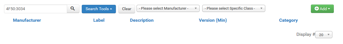

Yes, but unfortunately I cannot find that device in the database so it won’t help
@Marc_Vieira-Cardinal , could you please post the xml file for that device from your /userdata/zwave folder?
Thanks for the replies all, I forgot to mention that I tried looking for that device in the DB and as mentioned by @sihui I had no luck finding that one. I can’t upload the XML (new users cannot upload attachments) but here is the content of the userdata XML for that device:

My device is still showing up as unknown and I don’t see https://www.cd-jackson.com/index.php/zwave/zwave-device-database/zwave-device-list/devicesummary/1157 in the list of supported devices when looking at the binding.
Is there something else I need to do?
