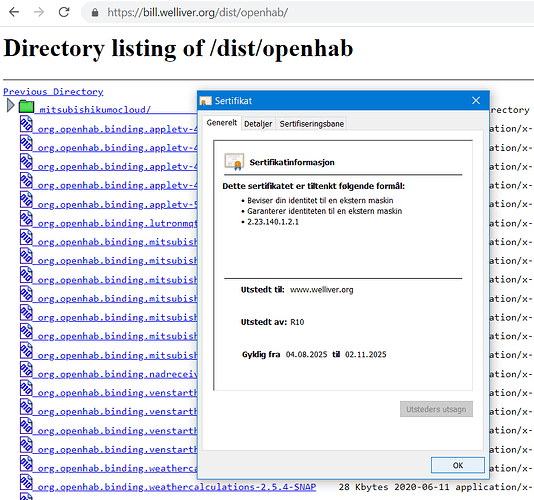

Just tried it from my Windoze work computer and Chrome doesn’t like it, either:
net::ERR_CERT_AUTHORITY_INVALID
It does, however, accept my own let’s encrypt certificate I use for my webserver, so there’s definitively something amiss with Bill’s certificate.
No biggie, though, next time I just download with http instead of https.
What exact link are you trying? It’s not like my Firefox doesn’t complain if it thinks there’s an issue, so I find this very strange. I’d never run Chrome though (because privacy), so I have no experience with it.
Here’s me using Chromium:
https://bill.welliver.org/dist/openhab/
Firefox doesn’t like it either, but that may be because I’m on a corporate network right now.
This is really bizarre, could it be that your corporation manipulates the trust store and don’t trust LetsEncrypt?
Or, is this some other “stupid” thing like timezone/time differences? That can make certificates fail, but it shouldn’t result in claiming that the certificate authority is invalid.
Either way, I assume that your Debian installation is free from “corporate control”, so that doesn’t really explain it either.
I fired up an updated Fedora VM I have, and “finally”:
wget https://bill.welliver.org/dist/openhab/
ERROR: The certificate is NOT trusted. The certificate issuer is unknown.
Failed to connect: Certificate error
I don’t get why this is though, my Windows computer things the certificate is OK, but Fedora doesn’t…
