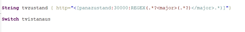

  1. In your Item File add:

rule “Panasonicrefresh”
Item tvzustand changed
if (tvzustand.state.toString === null) {
logInfo(“FILE”,“TV is off R:Panasonicrefresh” )
postUpdate(tvistanaus, OFF)
else if (tvzustand.state.toString == "1") {
logInfo("FILE","TV is  on  R:Panasonicrefresh" )
postUpdate(tvistanaus, ON)
