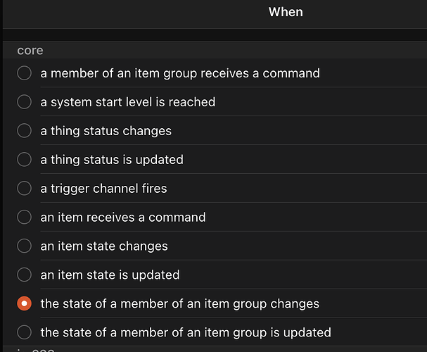

Try changing core.ItemStateChangeTriggercore.GroupStateChangeTrigger
I know it’s kind of misleading, but “ItemStateChangeTrigger” means you’re triggering on the Group as an item (because Group is a special type of an item).
Whereas “GroupStateChangeTrigger” means “trigger when a member of this group changed its state” and the event.itemName will contain the actual member, not the group itself.
On the UI, it looks like this:
