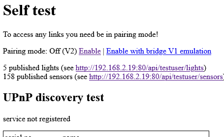

Do you have anything else you can use to check if the Hue Emulation is working, e.g. the “Hue Control” app for Android?
Are you able to capture the HTTP traffic to/from port 80 to see what’s going on?

getting my Hue Emulation not to work after having installed the reverse proxy nginx and runnning openhabian 3.1 as suggested is very frustrating for me.
I am wondering if this could be the reason for the Alexa discovery failing:
UPnP discovery test answer: “service not registered”. (screenshot of “http://192.168.2.19/api/status”)
If this is my problem, how do i solve this?
The reachability test gives me positive answers, so that should not be the problem.
I deleted the bridgeID, uninstalled and reinstalled the binding, started the discovery from multiple devices with Hue Emulation V2 or V1 and with or without “unknown user keys”.
Thanks for your help in advance!
Eckart
From another thread with UPnP and Hue emulation problems I found the idea to try different ports in the advanced settings of the Hue emulation. Setting it to port 8080 worked for me.
Problem solved for me!
By the way, the api-page stills says UPnP service not registered, but Alexa found my devices.
