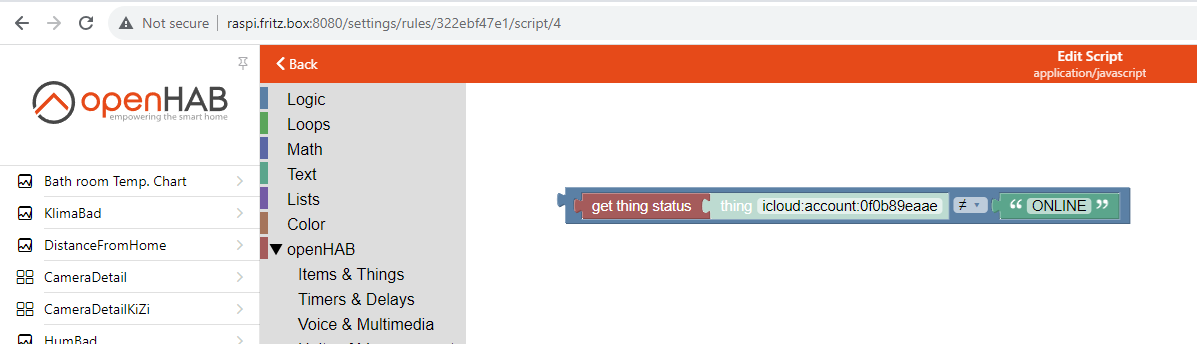

Hi all,
just a stupd question from my side
rlkoshak:
But only if: Conditions
We have the when and the then so now we need the “But only if” to limit when the rule can run to between sundown and 23:00. Add a condition and choose a Script Condition and select Deign with Blockly as the language.
A script condition is just like an action except the last statement execute must evaluate to a boolean (true or false). When it’s true the actions will execute. When false it won’t.
Is something like this in total sufficient as true / false ?

Yes. All of the comparison operations return a boolean.

I was just a hit confused that no „return“ keyword is required.
BR
/Franz
