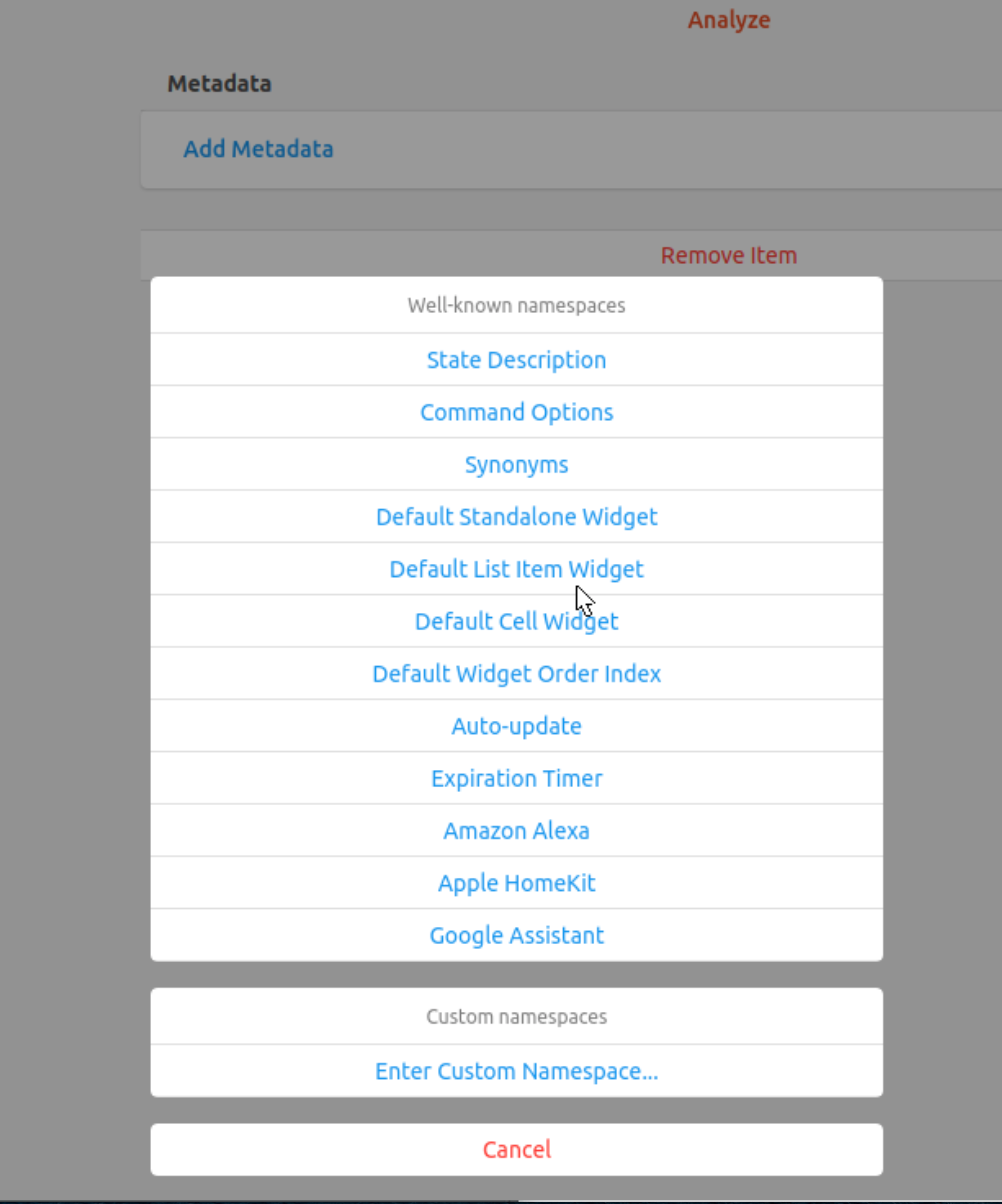

To change how an Item is shown in the automatically generated parts of the UI you need to override the default by setting a default widget in the Item’s metadata. In this case you need to tell it to use a setpoint or slider in the default list item widget.
EDIT
now i found the option, i was blind.
THANK YOU !!!

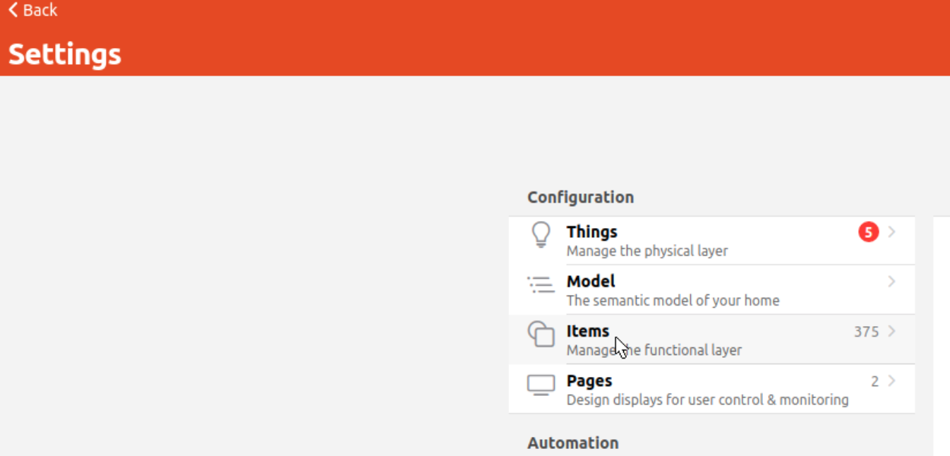

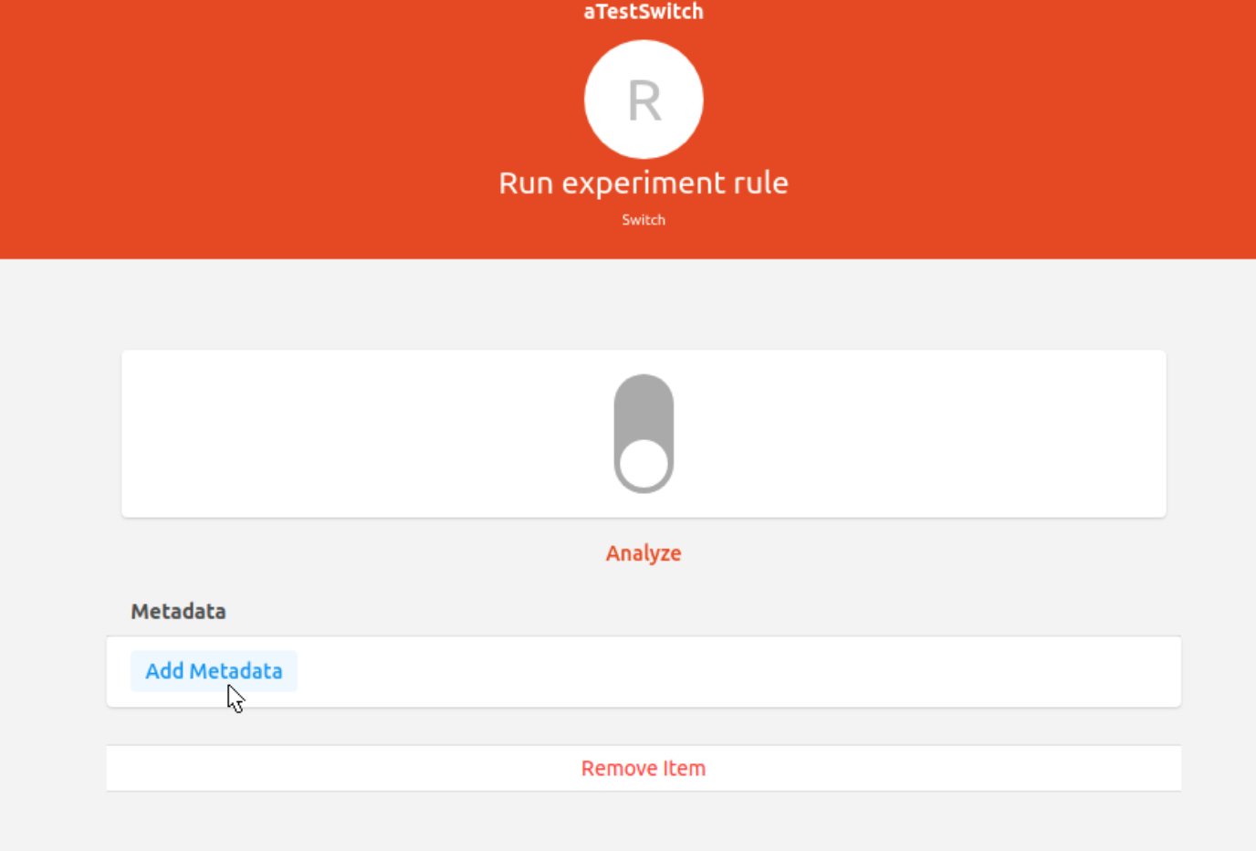

Go to the Items page under Settings → Items. Click on “Add metadata” Choose “default list widget”. Fill out the form to define the way that Item is represented.
Your screen shot is from the Thing, not the Item. The Semantic Class and Property have nothing to do with this.

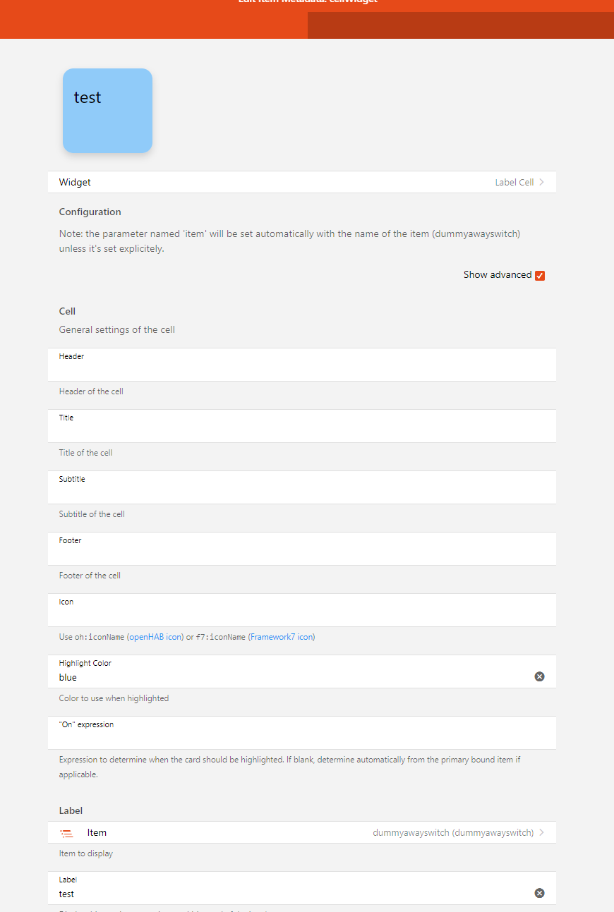

i want to change the label-cell color based on a status of a switch, the values are “ON” or “OFF”.
i tried this
=parseInt(items.dummyawayswitch.state.toString) == OFF? “green” :
parseInt(items.dummyawayswitch.state.toString) == ON? “orange”: “red”
but he always shows “green”.
why do you parseInt ? :slight_smile:
what can i else use?
i tried
=items.dummyawayswitch.state == OFF ? “green”: “red”
in the developer test console it works when i change the OFF to ON the green and red changes.
BUT the label-cell dont gets green, it changes the color to red when the status is ON but the cell changes to black or default color when the status is OFF
I assume you mean this colory thing like here: ?
as far as I understand the label
the color you choose is for the highlighted version. there is no way to define the non-highlighted color
