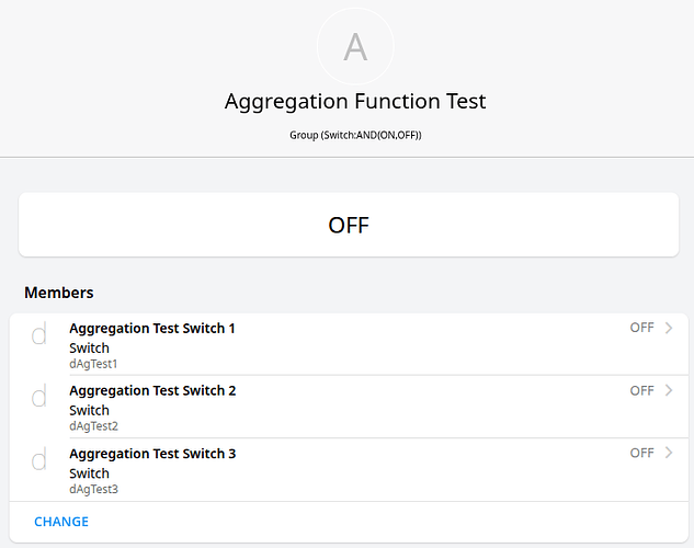

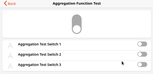

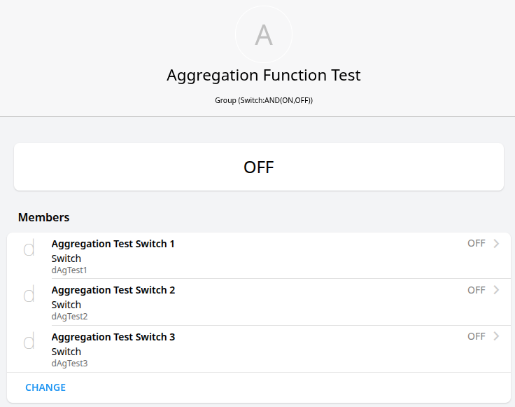

I am on a recent OH shapshot and I cannot reproduce this behavior at all. Here’s a quick test example: 1 group with All ON then ON else OFF and three switches:
Clicking on the card with the group state, brings up a handy testing dialog with toggles for the group and the switches:
agTest
You can see from the video above that there is no instance of toggling one of the Item switches that impacts the other Item switches. There is no OH core way to do that. Only using the group toggle to send a command to the group item results in all the switches reacting at once.
Given that I cannot recreate the bug in a recent snapshot, and I see no issues or PRs that have addressed and error such as this in the UI or Core repositories, the most probable explanation is that you have some other rule or connection. Even if the Item in question does not show up directly in a rule, then perhaps it can trigger a rule because it is a member of some group and that rule causes your group Item to receive a command that then propagates to all the other items.
However, it is possible that this is a bug in some other area that my test doesn’t cover (such as the shelly binding) so, it would be very helpful for you to find the actual cause and report it if it is a bug.
