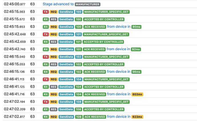

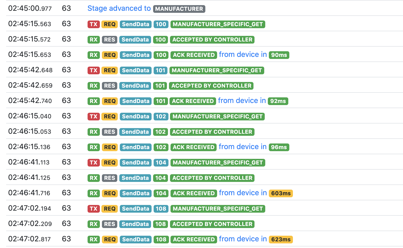

The binding sends the request to get the manufacturer data - the device responds with the ACK to say it received the request, and then doesn’t send a response. This is repeated 3 times, and the binding then gives up, but this leaves the device unidentifiable.

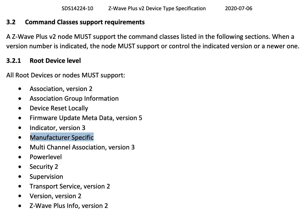

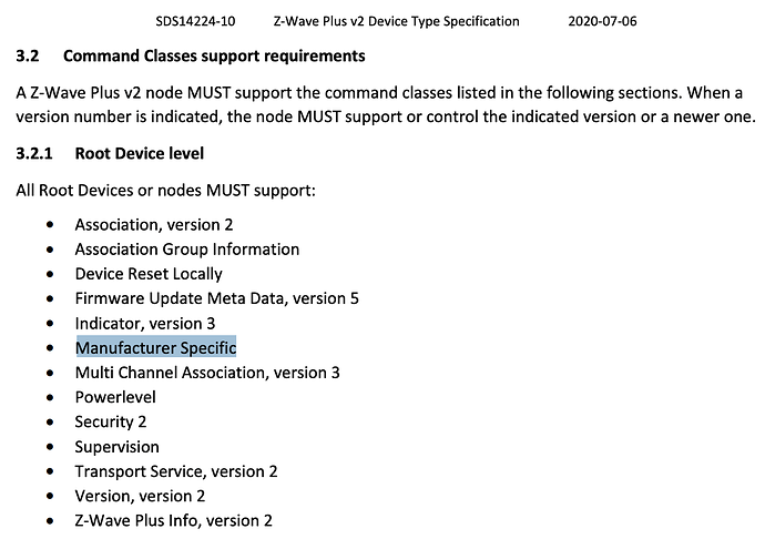

I think, unless there’s been a recent change to the ZWave spec, that not supporting this feature makes the device non-compliant to the ZWave standard . OH relies on this to work out what the device is, so we’re a bit screwed.
