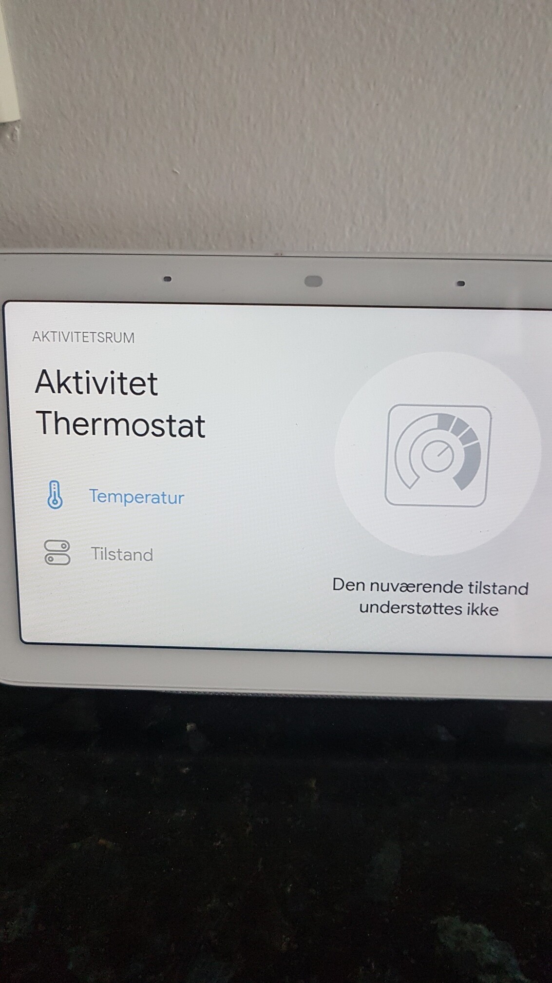

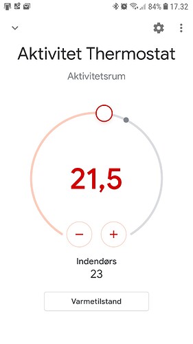

It´s pretty weird to be honest. But I believe it´s an Google issue:
This is a sccrenshot of one of my thermostats using the the Google Home app, which works just fine:
And this is the exact same thermostat on the Google Nest Hub.
Text says “The current state is not supported.”.
It seem no one can really answer whats going on..
This is my items setup for this thermostat (it´s actually a combination of a temperature sensor, temperature setpoint and the actuator).

Its all temperature and heating modes which doesnt work on the Google Nest Hub. In fact, I just tested.. It seem to be a problem with a plain temperature sensor and the CurrentTemperature tag.. Its the same, it doesnt work on the Google Nest Hub.
