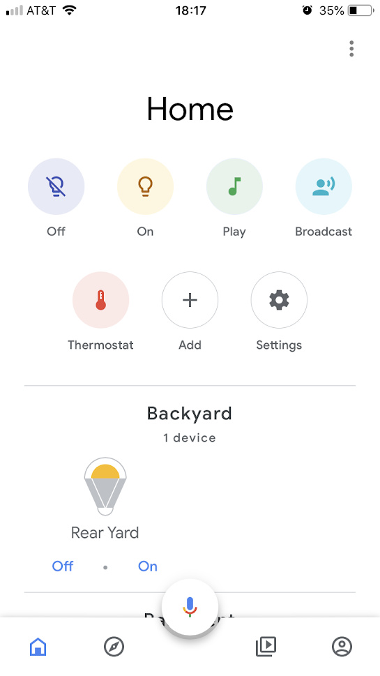

Are your item labels (the “name” in quotation marks) possibly too generic? I find that if i have have to items with names that are too close to each other, Google will sometimes tell me the same “I don’t know which ____ you want to turn off”. Try making something very unique in the label, and then sync your devices and try operating it again…
Also, take a look at your Google Home app on your phone, and see what Google is actually hearing you say…

Ok, so the configuration looks good, how about when you log into your myopenhab.org account, click on your account name and “Applications”…do you still see Google listed there?
Then I really can only recommend looking at your Google Home app and seeing what Google is understanding when you say the item name. Other than that - it might be a local outage where you’re located (mine definitely is working, as is @Kim_Andersen 's
