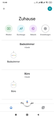

So currently voice commands do work again, but all my devices are gone in the google home app, but harmony devices. These are still there
thanks for the hint, but nothing changed. in general everything works but all my items are gone in the google home app. About 20 lights and 10 rollershutters in different rooms :-/

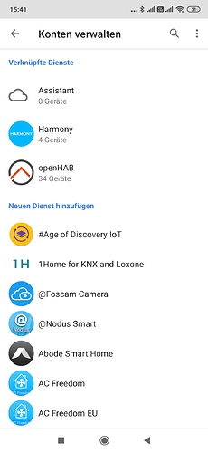

google home app on my phone. I see all my rooms, which are more or less empty. they just contain a few google home devices or logitech devices. Usually on the bottom (when you scroll down) you can see “new” devices which haven’t been added to your home yet, or assigned to a room. but there is nothing listed. What is strange in the settings menu I can see the openhab connection and 34 devices, which I cannot find anywhere.
