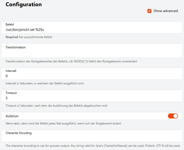

Since I only need outputs, I implemented a simple workaround using the EXEC binding.
For inputs, slow polling would still be possible, but without edge detection. Therefore, an interrupt-based solution is not feasible with this approach.
EXEC binding configuration
command="/usr/bin/pinctrl set %2$s", interval=0, timeout=5, autorun=true
I use only a String item as the input parameter and set it, for example, to:
10 dh
or
10 dl
This switches GPIO 10 accordingly.
For pure output use cases, this is currently the simplest solution in my opinion.
