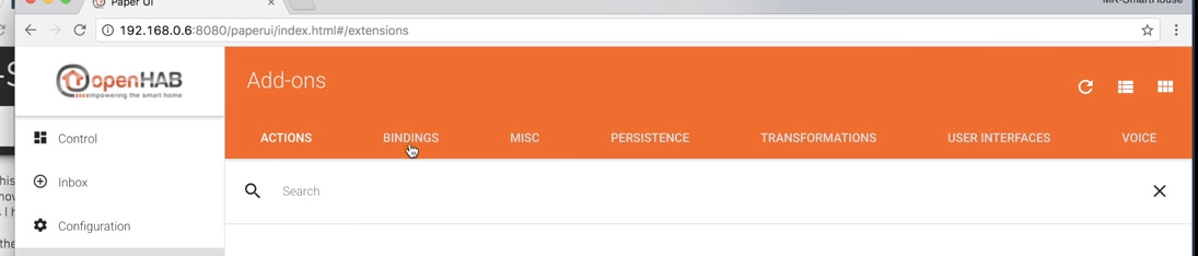

I was watching tutorial on how to use gpio with gpio binding add on. He found it and installed it inside ip:8080/paperui/index.html#/extensions link, but i cannot find it. All i can found it’s onewire gpio.
Tutorail: https://www.youtube.com/watch?v=JL1-_uIPDNs time: 1.56
Is there a diffrent way of adding this?

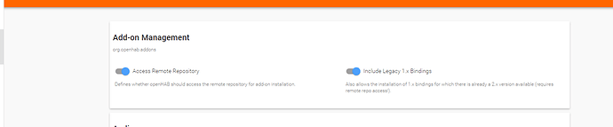

You might need to enable legacy add-ons in the PaperUI settings. It should be installable from PapeeUI.
tryed, didn’t work

Confirm you are looking at “Addons-Bindings” (the list of available bindings) and NOT at Configuration-Bindings (the list of installed bindings). Your posted link will show the Actions tab and NOT the Bindings!!!

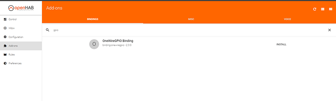

The same search on my system shows the OneWireGPIO and the GPIO Binding. Since the later is a OH1 binding with no OH2 successor the legacy bindings do not have to be selected. So it must be something else. Do you see any OH1 binding at all?

A wild guess: Do you have “Access Remote Repository” selected? (Under Configuration-System-AddOn Management)
in tutorial he has 7 options in add-ons
but i only have 3
is that “better” or never version of openhabian
You can only see the first seven of all the bindings (I didn’t bother to count them).
