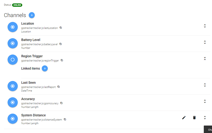

No, I have the following channels : Battery Level, Region Trigger, Last Seen, Accuracy, Home Distance and System Distance channels in PaperUI Configuration > Things > XYTracker
Is it really the Location channel missing ?
If so create another tracker thing, that should come with this channel by default.

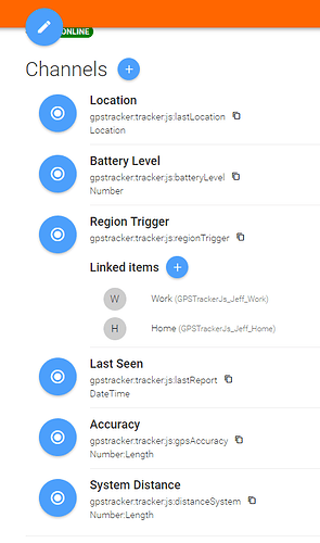

Damn, thought I had it, but the geofence switched didnt seem to work. My PaperUI config:
and my items file:
Location        GPSTrackerJs_LastLocation_Jeff     "Location"           {channel="gpstracker:tracker:js:lastLocation"}
Number          GPSTrackerJs_BatteryLevel_Jeff     "Battery Level"      {channel="gpstracker:tracker:js:batteryLevel"}
DateTime        GPSTrackerJs_LastReport_Jeff       "Last Seen [%1$tA, %1$tm/%1$td/%1$tY %1$tH:%1$tM]"          {channel="gpstracker:tracker:js:lastReport"}
Number:Length   GPSTrackerJs_GpsAccuracy_Jeff      "Accuracy [%.0f ft]"           {channel="gpstracker:tracker:js:gpsAccuracy"}
Number:Length   GPSTrackerJs_DistanceSystem_Jeff   "Distance from Home [%.1f mi]"    {channel="gpstracker:tracker:js:distanceSystem"}
Switch          GPSTrackerJs_Jeff_Home             "Home"  (gPresentHome, gLocationStatusPersist)    {channel="gpstracker:tracker:js:regionTrigger" [profile="gpstracker:trigger-geofence", regionName="home"]}
Switch          GPSTrackerJs_Jeff_Work             "Work"  (gLocationStatusPersist)    {channel="gpstracker:tracker:js:regionTrigger" [profile="gpstracker:trigger-geofence", regionName="work"]}

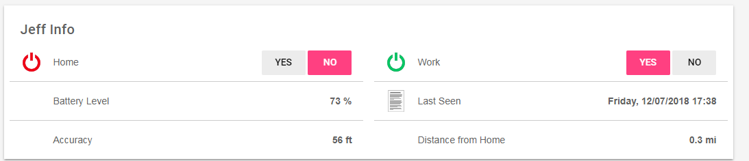

I have home and work regions set up in the Owntracks app. They are set up as shared and have a 100m radius. I also see a little timestamp appear by each (in the app) when I cross the region. OH sees all the other data from the app, just not setting the geofence switches.

So it sure looks like the message is coming thru, just not changing the state of the switch item!
