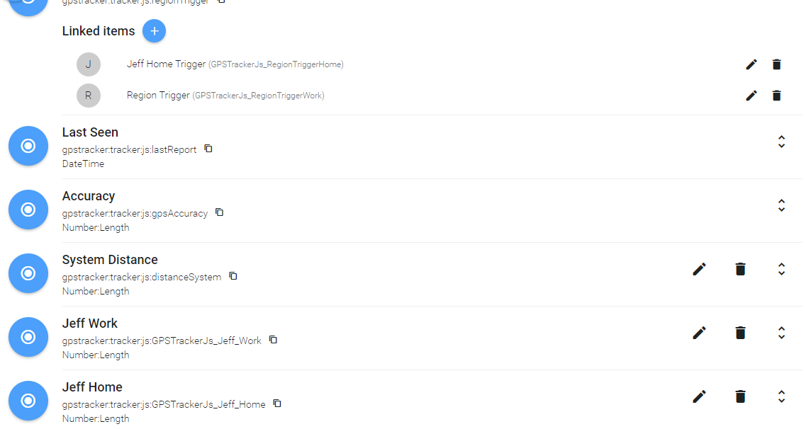

Define Distance channels in the binding. This way every location message will maintain this internal state which is a frequent event. Depending on you mobile app settings of course…
Then how do I turn that into a switch? A rule?
The same way you are doing it now. When you link a switch under the trigger channel you’ll have the Distance channel names in a dropdown or manually use the same region name in the items file you used when defined the distance channel.
BTW the SystemDistance channel can be used as Home…
I think I might have it configured correctly, but anyway you could explain how to do it in the .items config file? Here’s what I have in PaperUI:
