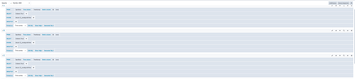

For the three phases I use the grafana wizard:
The “Total Pac” was a trial and error approach without knowing what I really do :roll_eyes:
However, removing it doesn’t work → Values ar wrong even for small time ranges

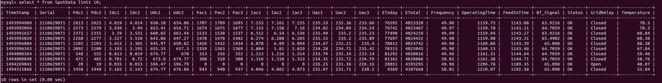

FYI:
SBFspot ( GitHub - SBFspot/SBFspot: Yet another tool to read power production of SMA® solar/battery inverters ) only puts the power of the three phases in the SQL history:
The total power is overwritten on each call to SPF spot in the sql database:
So I though I just sum Pac1, Pac2 and Pac3 to visualize the total power.
