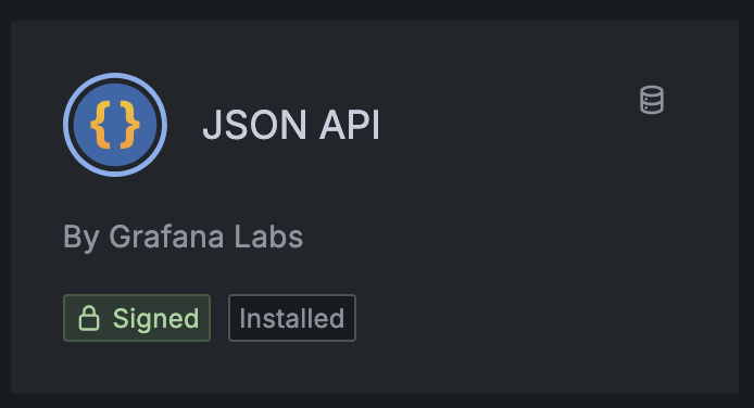

  • Grafana is installed, including Plugin “JSON API” in version 1.3.23.
    • Again, at your own risk. Yes, this plugin is in maintenance mode and the version is not the most recent one. The latest version is broken and the recommended plugin “Infinity” is bloated and confusing, can’t get it running. I might extend this tutorial, once I get infinity running…

In Grafana, create a new Datasource using JSON API. Enter the following fields and then press “Save & test”:
  • Name: Your Choice :sweat_smile:
  • URL: http://{opehab-host:openhab-port}/rest/items/
  • Authentication: No Authentication

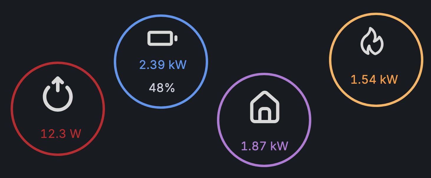

Create Canvas
Create a new canvas and add a query. Select the Data source you created before. Now it depends on the amount of data you want to visualize. There is an open issue that using multiple queries will end in “NO DATA” eventually. For me, it stopped working after five values. If in doubt, use the multi-value setup to be safe.
Single/few values
Add a query for each value. Configure each as follows:

For Both
Disable cache (e. g. cache time 0s) for each field to always fetch the most recent value.
Conclusion
Add metric values to dashboard and select the fields you created. Now you always get fresh values without persistence.
