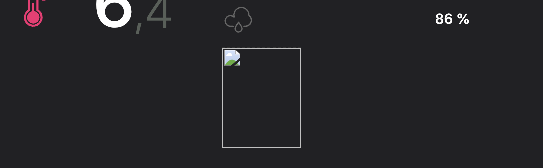

The problem is that the same url doesn’t work in HABpanel:
<img width="250" height="100" src="http://192.168.1.57:3000/d-solo/_18XpB1Mk/utetemp?orgId=1&from=now-24h&to=now&panelId=4&width=500&height=100&frameborder=0" />
It only presents an “empty” image box. If I RMB “Open picture in new tab”, the graph shows up as it should. Any ideas?
Not sure why but when I started all over again and generated the url, I got an extra “render” after the host:port and for some unknown reason. This url works just fine. Happy days :grinning:
http://192.168.1.57:3000/render/d-solo/_18XpB1Mk/utetemp?orgId=1&from=now-20d&to=now&panelId=4&width=500&height=100&frameborder=0
