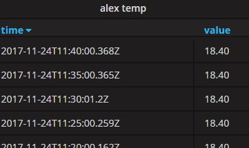

Display data in a table is working fine, just like you said, just use SQL statement.
eg
SELECT * FROM xiaomi_th_alex_temperature_0026
But I would like to have this data in a graph.

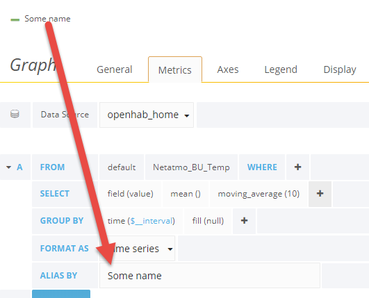

I’m only missing how I can give the series a name, now all of them are called ‘unknown’:
That’s the label for the graph/table it selves, not for the series.
With InfluxDB as a datasource you have this option:
I only use the Table Panel for MariaDB data, so I can’t say if it has that option as well.
