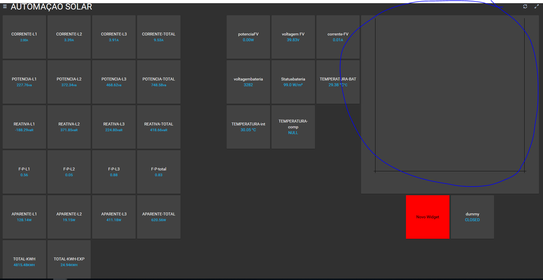

Hello! I dont know exactly what is heappening with the graphs widget.
It used to work well.after update to 2.5 yesterday, my graph is like that can not see any data anymore.
somebody knows what is heappening ?

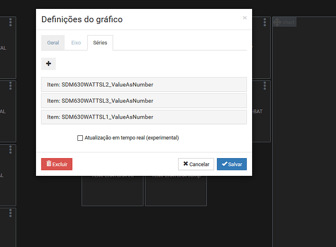

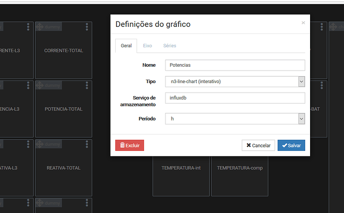

Did you set an item correctly as the resource to be shown? Please post all settings for this graph.

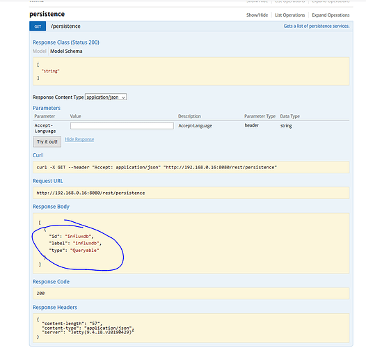

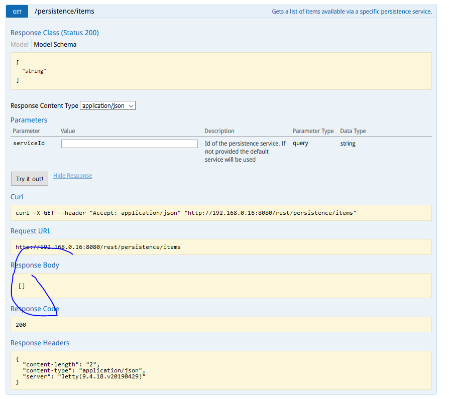

Is the persisted data for this item available? Check with the REST API.

the configurations of the widget was made using paperui.
Without any data persisted each graph would be empty!
The picture shows a HABPanel UI, the setup of this UI can not be done via PaperUI!
sorry confused paper with habpanel.
yes is that. i made it from hab panel.
how i could test for persistence working?
Logging 3 phase power datas

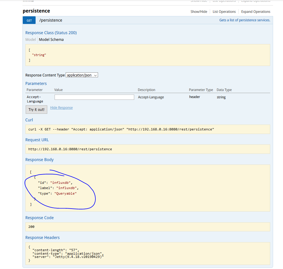

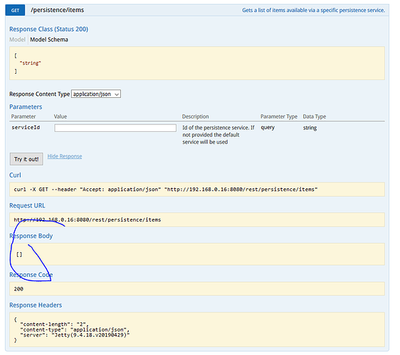

As said before you can use the REST API in order to check if values are in your database.
yes, you area right i think.
Soo, i SHOULD make a .persist file for the items ? i belief it was created automatically by HabPanel…

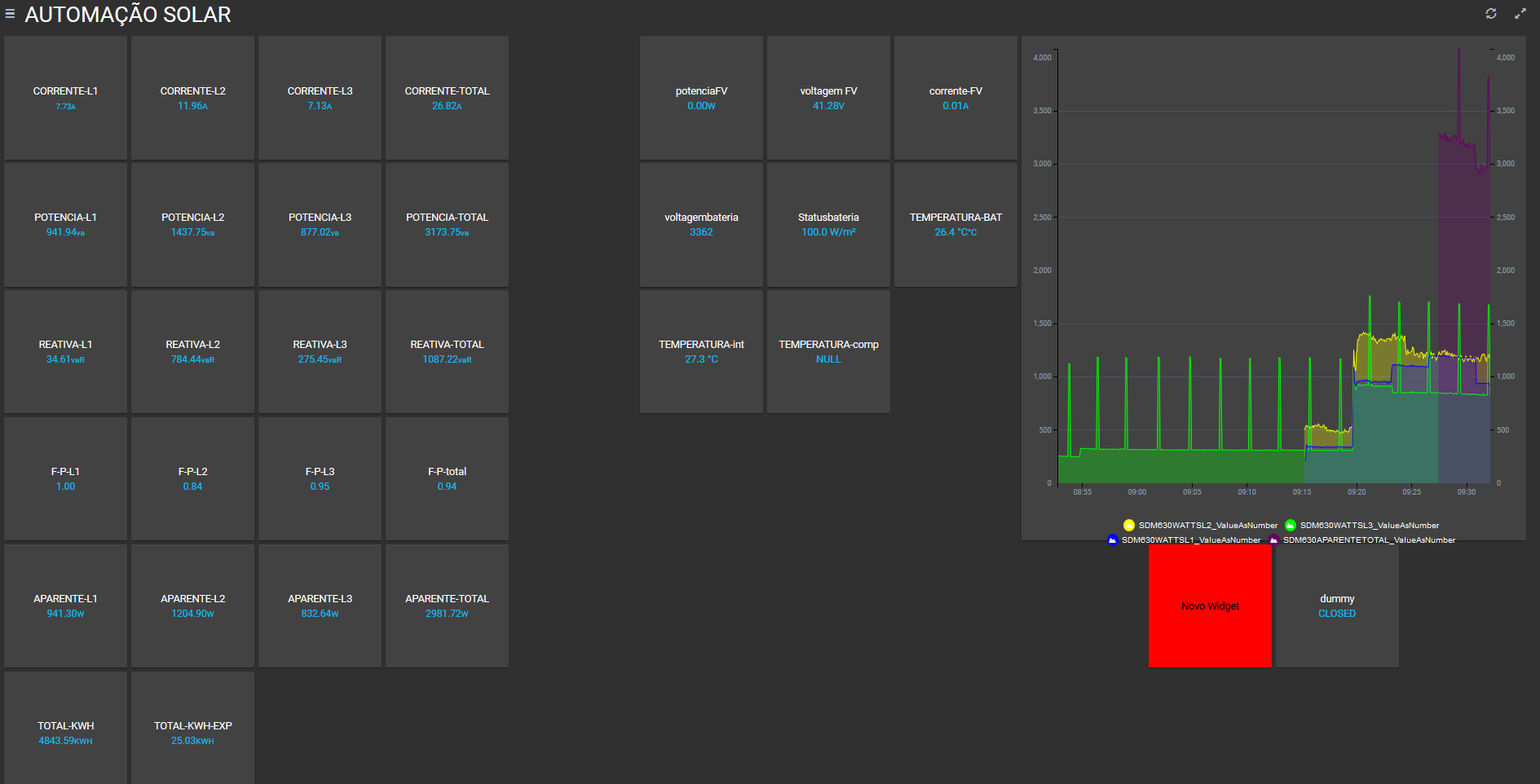

![Capture|666x431](upload://br4gp6ImotvwX9RTZMZ0ho48FTk.png)
now its working PERFECTLY!
