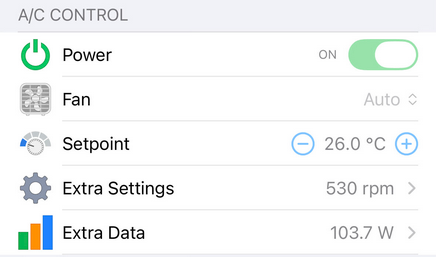

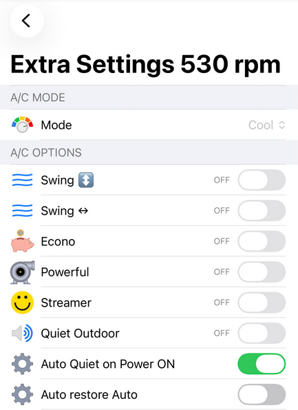

Here are the screenshots
iOS - App - Grayed out and impossible to interact with:

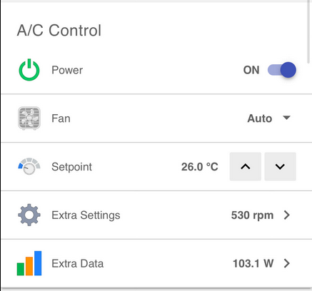

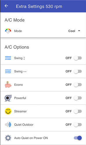

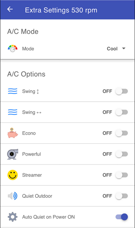

iOS - Browser - Everything normal:

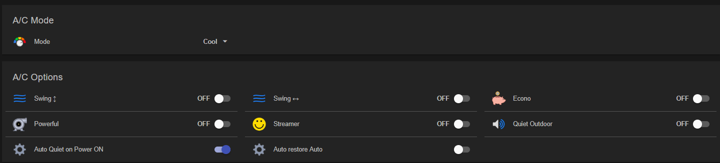

PC - Browser - Everything normal:

@DigiH is giving the right direction.
The issue is not a bug in the iOS app — it is a server-side mismatch between stateDescription.readOnly and actual item commandability, triggered by certain binding configurations.
What happens technically
  1. The iOS chain:
    Server → stateDescription.readOnly = true in EnrichedItemDTO → OpenHABStateDescription.readOnly = true → WidgetRendering.readOnly = true →
    ToggleRowInput.readOnly = true → .disabled(true) on the Toggle in SwitchRowView
  2. Why readOnly = true is sent:
    The MQTT binding marks items as readOnly: true when they are linked to a state-only channel (e.g. an MQTT state topic with a JSON path transform). Even when a separate command channel also exists (making the item genuinely writable), the stateDescription is derived from the state channel alone and incorrectly carries readOnly: true.
  3. Why in the label is a workaround:
    Adding to a sitemap widget label forces the openHAB server to re-evaluate the embedded item’s state description via its label pattern resolution code path. This path appears to pick up the aggregated state description (considering all linked channels), which correctly produces readOnly: false. Without , the server uses a faster path that propagates the raw channel-level readOnly: true.
  4. Why it appears fine in BasicUI / web:
    Historically, no sitemap-based UI respected the readOnly flag at all — only MainUI did. The Android and iOS apps now correctly honour it, which surfaced the latent server-side bug. BasicUI/old sitemaps still ignore readOnly entirely.

Thank you @Hans_Lree for pointing me to the right direction and thanks to @timbms for the detailed server sided explanation.
As a matter of fact the issue was indeed the missing commandTopic
After adding it, it works. I won’t bore everyone the whole sitemap json (unless it’s useful, then I’ll gladly post it) but this is a working item with commandTopic correctly set up

With the commandTopic missing in its item definition:
        Type switch   : quiet           [stateTopic="state/faikin02/status",  transformationPattern="JSONPATH:$.quiet",    on="true", off="false"]
And the readOnly is indeed set to true as per @timbms explanation.
