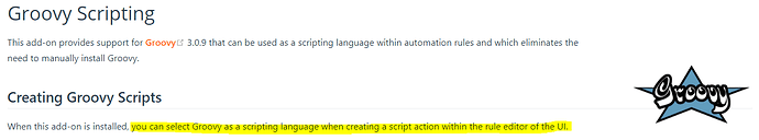

I’ve installed the Groovy scripting plugin in version 3.2.0
When I try to create a rule, I get to this screen;
I was expecting to see Groovy as choice here. I assume I’m not understanding this correctly. What is the process for doing this?

Not many are using Groovy and I’m not 100% certain it can be used in UI rules in the first place. Not all of the automation add-on support UI rules.
The docs seem to suggest it does. They also say “Groovy scripts provide access to almost all the functionality in an openHAB runtime environment”. So seems worth looking at. It’s the most “Java-esk” of the scripting languages, so I’d like to give it a shot.
Just can’t seem to get started.
@rlkoshak … ah… figured it. it was running with JDK 17. Switch to 11 and the other scripting languages appeared!!!

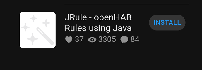

A little bit further down the list from the Groovy plugin:
Forum post here
There’s another Java rules system available from this external repo:
Thanks, I did see that too.
But the groovy one looks a little more integrated, if only I could get an example of how it worked!!
I might look at the too, but I’d at least like to get a handle on how the Groovy one works and it’s part of the core OH3 addons.
Something really simply like, checking the state on an Item to set another, should be enough to get me going.
But if I can’t get anywhere with the Groovy one, which would be disappointing, that’s my next stop.
I’m fully aware. I’m referring to JRule - openHAB Rules using Java ( got the name wrong), not JavaScript Scripting - Automation | openHAB.
