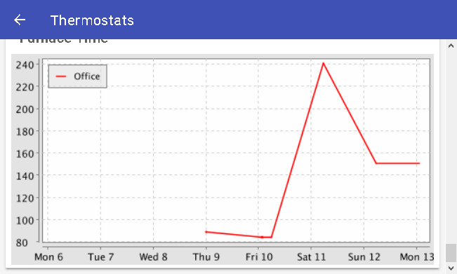

I have temperature data stored in jdbc for multiple items using a rule (not a persistence file config). When I try to graph an individual item it works, but the group is always blank. I think I have followed the directions (naming each item separately). Is there any limitation with groups and jdbc data?

If I change the chart item to be just one item it works:
one
But the group item is always empty:
two
Not sure if I am doing something wrong. The data for all items is in the database.
