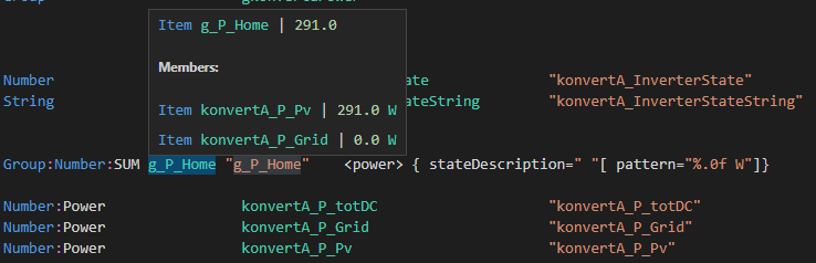

does stateDescription work for a GroupItem?
in VScode for items the right displayState is shown, but not for the groupitem.

Missed this at first; you’re summing Number:Power types.
Group:Number:Power:SUM g_P_Home ...
I’m not convinced that will help much.
MainUI is weird about this, who knows. Maybe in this UI it inherits from members. Maybe it would still see it the old fashioned way.
Group:Number:Power:SUM g_P_Home “g_P_Home [%.0f W]”...

sorry i made a mistake with the props
text: =items[props.Konv_HomeGrid_power].displayState
with
Group:Number:SUM g_P_Home { stateDescription=" “[ pattern=”%.0f W"]}
works.
