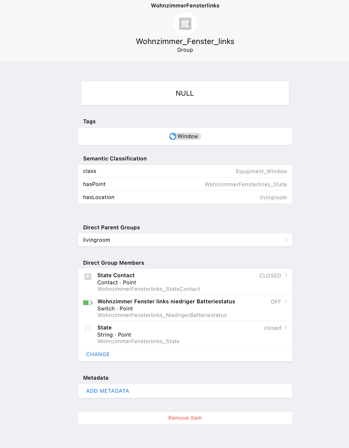

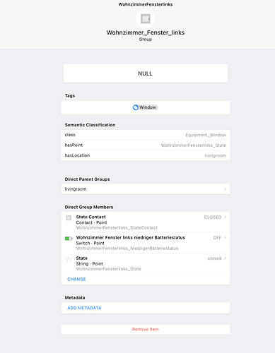

I would like to use the “ContactSensor” type for my windows from Apple home because the window type is for motorized windows.
Now I have the problem that the group needs a status. ON / OFF by default the group is null but yes does anyone have a solution here? I want to use the group because I also want to pass the optional parameters like battery status.

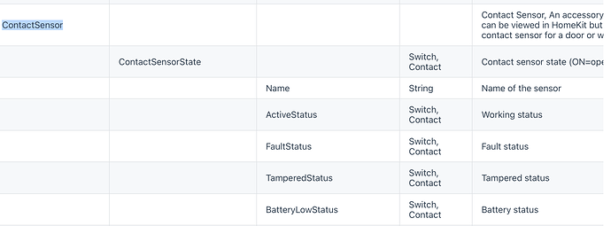

Yes, I also have groups for windows and for batteries. But look at the Apple documentation. Here it is used differently and batteries must be a sub-item
you dont need to have state at group level.
add following homekit metadata
group → homekit =“ContactSensor”
WohnzimmerFensterlinks_StateContact → homekit = “ContactSensorState”
battery → homekit =“BatteryLowStatus”
