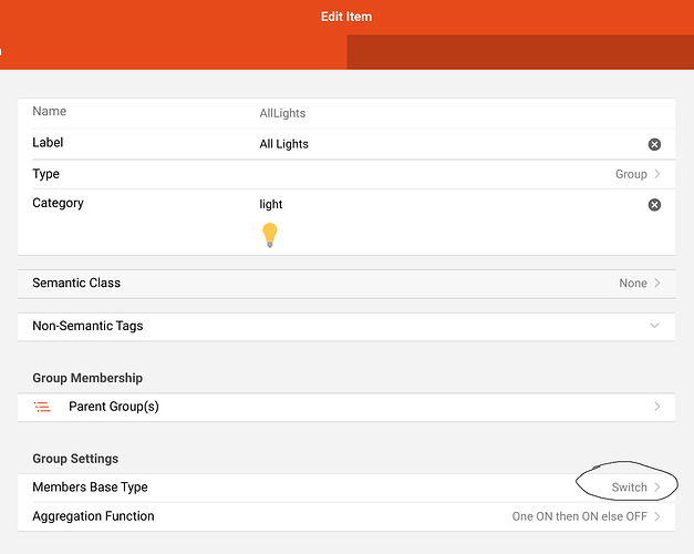

You need to give the Group a subtype to Switch.
label: All Lights
type: Group
category: light
groupNames: []
groupType: Switch
function:
  params:
    - ON
    - OFF
tags: []
You don’t necessarily need a function too but it is usually helpful. Without it when you command the Group it won’t change state and the UI won’t know if you’ve turned it ON or OFF and the UI element might not let you command it again.

Thanks again! That fixed it for me!
Yeah, sorry…
That’s the missing part, thank you!
