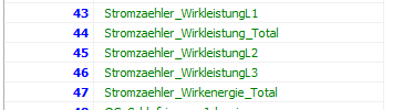

So far so good. But it just dont want to save them in my msql. All other items are in.

it worked before… so what did I forget? or is there something wrong with the GA format in my things?
