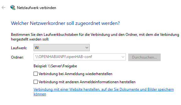

Is it a Windows Computer, where your VSC is installed ? If yes try to connect your openhab-conf share as a network-drive with a letter

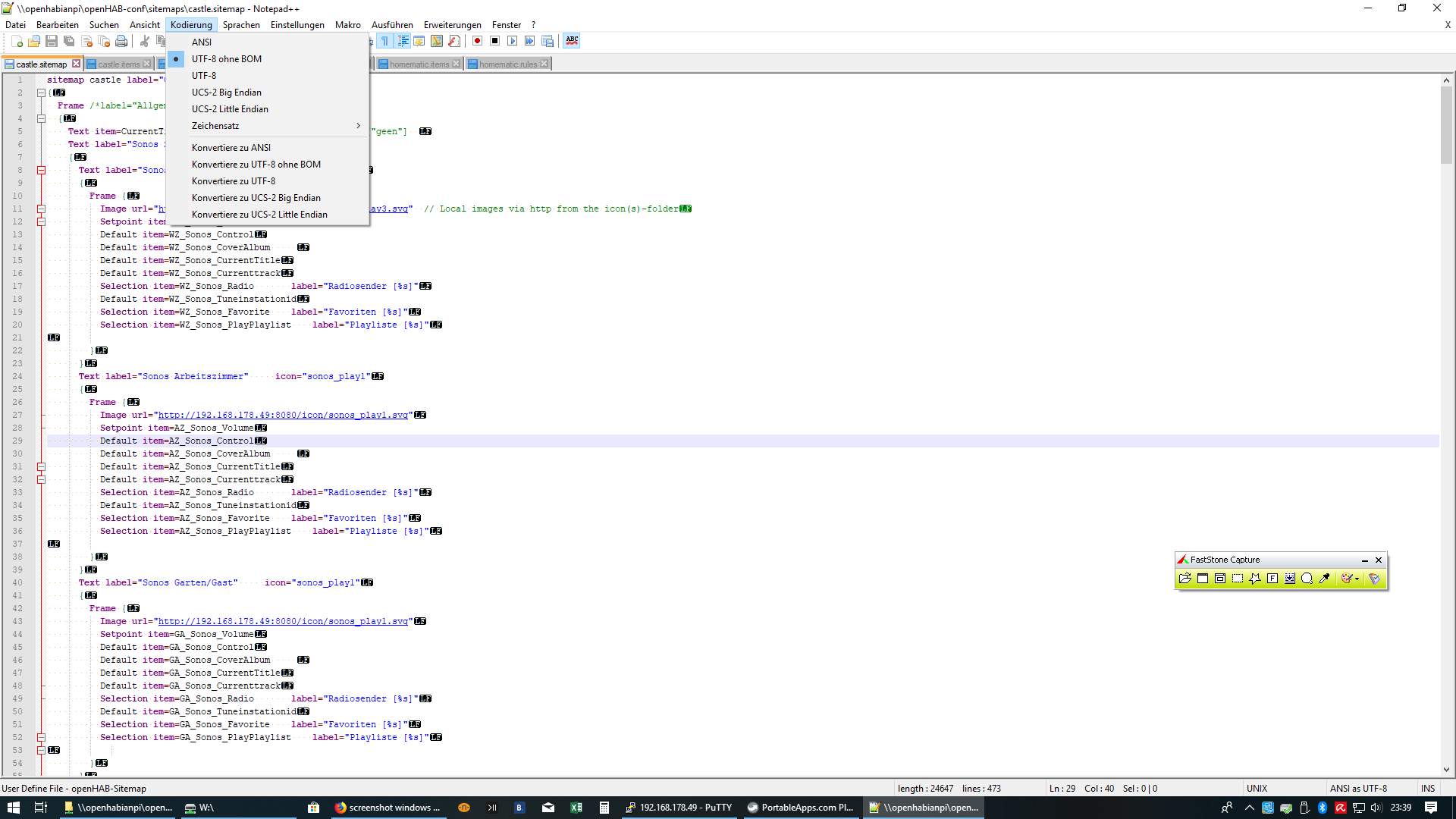

What Notepad++ Version ?
Mine is an older one with Version 6.53 and as in the screenshot I use the Kodierung “utf8 ohne BOM”

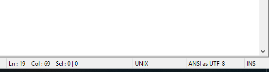

Your Editor should show you in bottom right corner the Type of your File, like in the next screenshot
grafik
Hope this can help you
Hi Peter,
yes it’s a windows computer and mounted the conf-directory to a drive letter.
