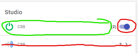

Currently, I’m controlling four power plugs in a set of two pairs from the basic UI like this:
While it works, this approach wastes a lot of screen space. It would be better to have a single entry with the switch on the right, but clicking on the area left to the switch brings you into the group (which is what the second entry from the screenshot is for).

I want to get rid of the red crossed entry. Instead, I want to use the red circled switch for controlling the group, but be able to click on the green circled area to enter the group (like clicking on the red crossed entry).
I’m basically looking for a group switch that I can use at the same time to enter the group and make fine adjustments there.
I suspect any implementation of that would require reworking of the several sitemap based UI, to distinguish clicks expected to open the sub-page from clicks expected to activate the widget.
