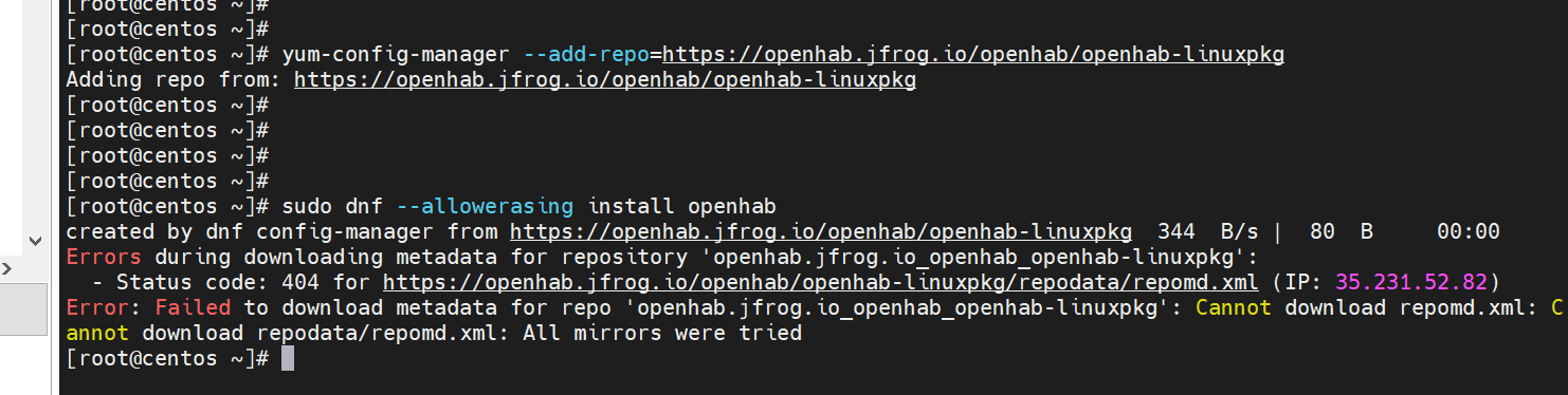

I have openhab2(working nicely). I tried to upgrade but I am getting stuck on the repo. I am on centos.
Hi @Marc_W1,
The repo name should be https://openhab.jfrog.io/openhab/openhab-linuxpkg-rpm
Thanks, that almost worked, I needed to add testing to the end. Just for others, did i miss something or should the install notes be updated with the “rpm” repo.
yum-config-manager --add-repo=JFrog
