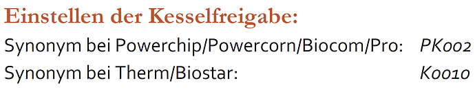

In order to support all the other channels for Biosmart, i was asking myself which parameter must be used for “Kesselfreigabe” - as it is not part of the heating system list (see screenshot above).
It might be, that Biosmart is not providing the channel for “Kesselfreigabe” at all!?

When comparing your and my mbmap.cgi, I can see that yours doesn’t provide the parameter “Boiler Approval”:
With this information I read the Guntamatic spec now in the way, that only pellets heating systems (Biostar, Powerchip, Powercorn, Biocom, Pro, Therm) are supporting this channel, but not log heating systems like Biosmart.
