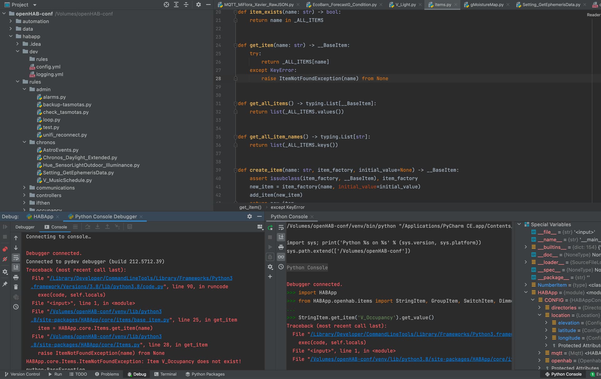

here is a screenshot:
HABApp running in a window
Terminal to Mac showing HABApp writing to log files
Python Console running, using same interpreter
HABApp imported, but didn’t read config file
I must be missing something dumb…
Everything is fine.
You receive events before the items are fully synced (last two log lines).
Once the Items are synced the warnings are gone.
Your rules should only run when the sync is complete so this is no problem.
but I still can’t get a value of an openhab item from the python console…
/Volumes/openHAB-conf/venv/bin/python "/Applications/PyCharm CE.app/Contents/plugins/python-ce/helpers/pydev/pydevconsole.py" --mode=client --port=55396
import sys; print('Python %s on %s' % (sys.version, sys.platform))
sys.path.extend(['/Volumes/openHAB-conf'])
PyDev console: starting.
Python 3.8.2 (default, Jun 8 2021, 11:59:35)
[Clang 12.0.5 (clang-1205.0.22.11)] on darwin
import HABApp
from HABApp.openhab.items import StringItem, GroupItem, SwitchItem, DimmerItem, NumberItem
DimmerItem.get_item('Hue_P8_BasementStairs_Brightness').get_value()
Traceback (most recent call last):
File "<input>", line 1, in <module>
File "/Volumes/openHAB-conf/venv/lib/python3.8/site-packages/HABApp/core/items/base_item.py", line 25, in get_item
item = HABApp.core.Items.get_item(name)
File "/Volumes/openHAB-conf/venv/lib/python3.8/site-packages/HABApp/core/Items.py", line 28, in get_item
raise ItemNotFoundException(name) from None
HABApp.core.Items.ItemNotFoundException: Item Hue_P8_BasementStairs_Brightness does not exist!
I can, however, create a rule in the development folder and it runs and can get values from openhab.
I just can’t interact from the console, which really was the goal…
