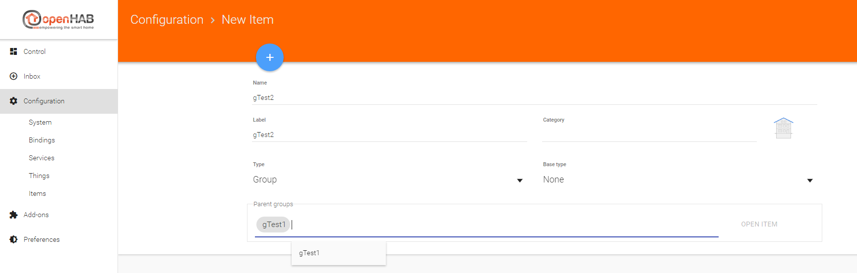

Perhaps I’m doing something wrong? I’m in PaperUI and trying to modify what I’m assuming you speak of - Parent Groups - is the label on the items. But nothing happens here:
All I can do is type in text, but nothing seems to “enter” it to the item. Return, Enter, click Open Item, etc. Hitting the checkmark to save doesn’t help either. Is it possible I have something that needs to be reloaded or a version of something that needs to be adjusted? I know I’m working with a beta version of the new 2.0 ZWave security binding, but I don’t think that should be affecting PaperUI functionality.

Hmm ok, so it seems if I populate an items file with the groups, they show up in the interface. But if I try to manually create them from the interface, they don’t get created. Is this expected behavior? Perhaps I wasn’t understanding the functionality properly.
It seems I may be on the right track now, but I just need to manually setup the Items file, then assign the items to the groups afterward.
