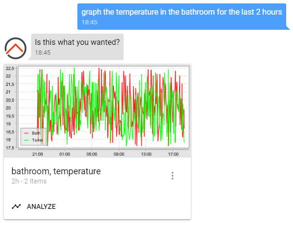

  • For historical data queries, an image containing the chart will be displayed, along with a button to open the Analyzer

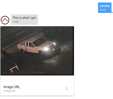

  • Cards can also show images (this needs some configuration, more on that later):

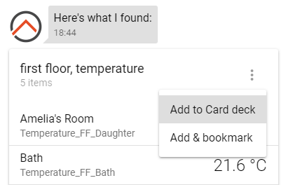

If you have a card you want to retain and potentially modify, use the context menu to add it to your “Card deck”:

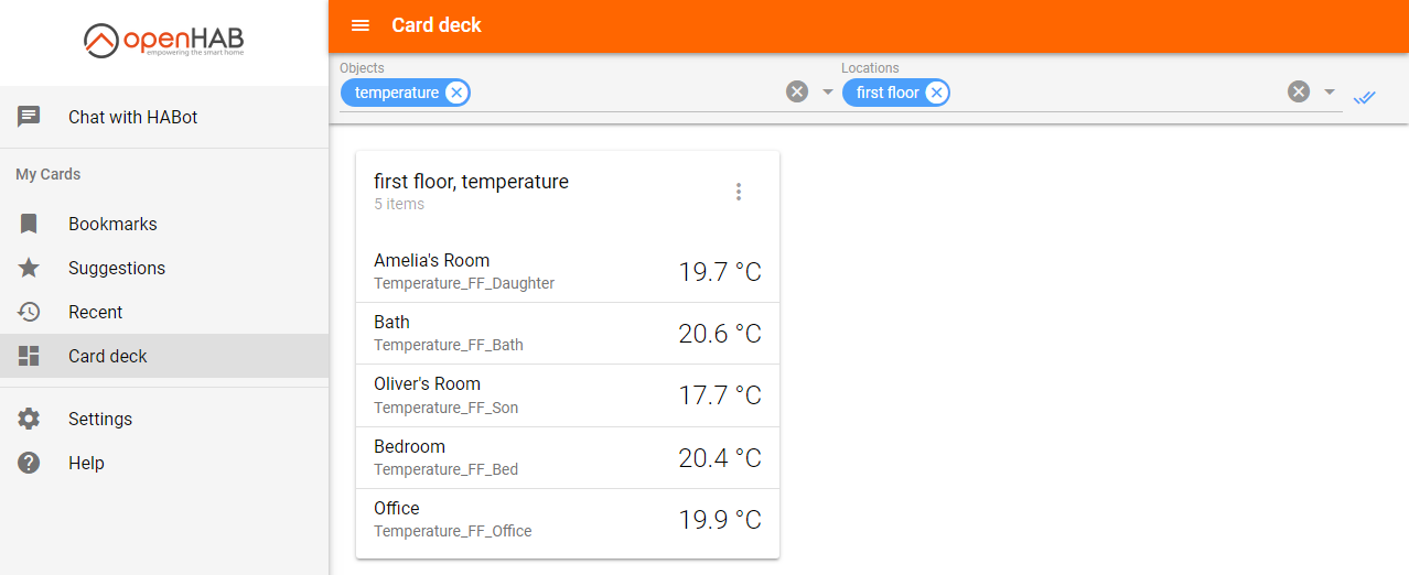

You will then find in the Card deck section - all cards must have at least one object or location attribute; therefore, when you save the card from the chat, it will have the attributes inherited from the intent. Using the filters in the Card deck screen, you can select one or multiple objects and locations and display the cards you saved matching those attributes. By default, only one object and/or location can be selected (to save clicks/taps) but you click the multiple choice button on the right, and then check all objects and/or locations you want to display at the same time. If both filters are used, cards have to match at least one selected object attribute AND at least at least one selected select location attribute.
A saved card can then be modified, or bookmarked: it will then appear in the bookmarks section and have a bookmark on its top-right corner. Use the bookmarks for cards you use all the time (like a scene switcher), to avoid cluttering the bookmarks screen - for the other things, you can go to the card deck and quickly select an attribute using the filters.

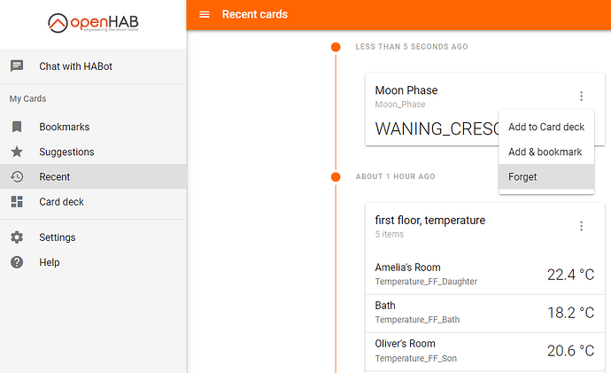

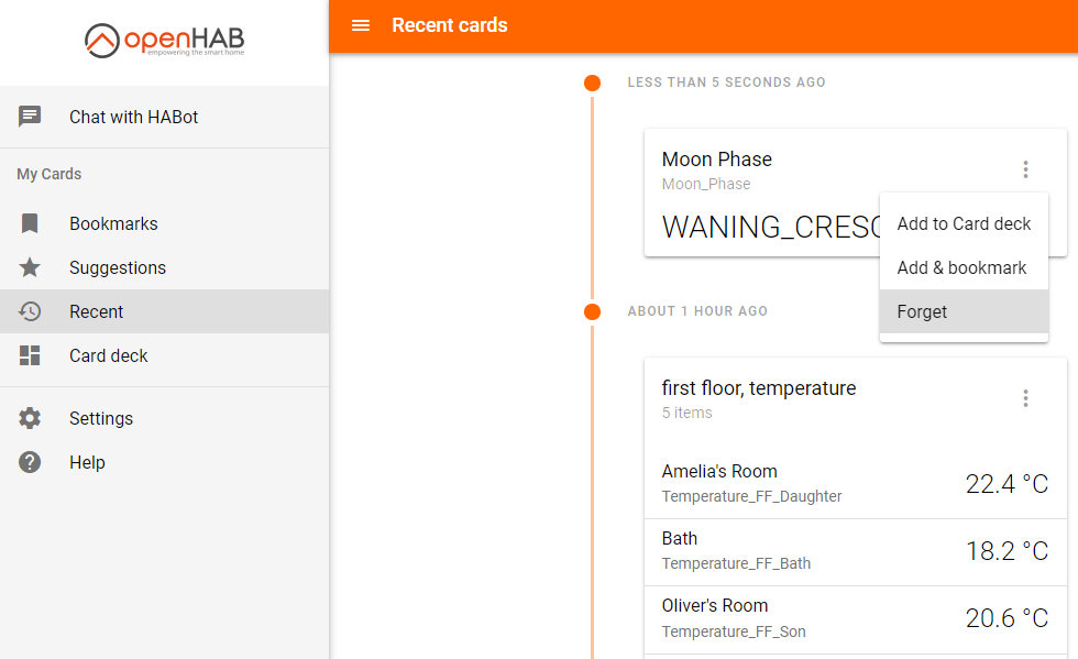

All cards encountered during the chat (and saved cards recently modified) appear in a timeline in the Recent screen. From there, you can also add, modify or bookmark cards, depending on their state. You can also “forget” autogenerated cards which were not saved (called “ephemeral cards” internally) to remove them from the list.
