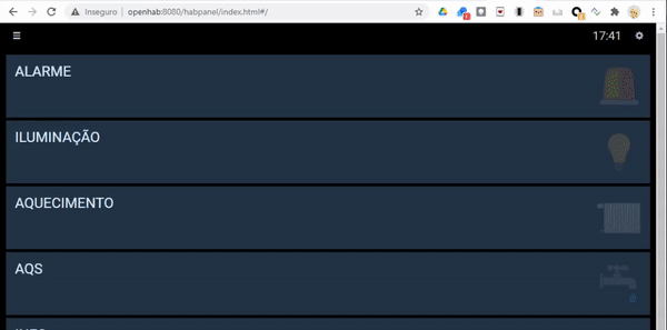

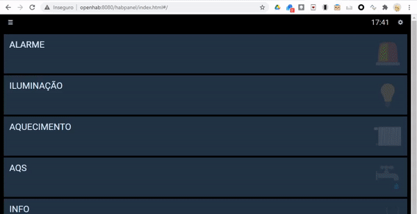

I’ll make a guess at race condition -
Maybe this kicks HABpanel to do a big fetch of all Items state on this page? Or even all Items on any page?
Business as usual, send command to openHAB etc,
Now the response to the big fetch has arrived from the host, including the pre-clicked state of your Item.
I’ve checked out this file, and I can see only events from items. No events from UI are coming in. How can I enable them?
From the browser console log, seems you are right:
Command sent: AQS_recirculation_power=ON
openhab.service.js:182 Updating AQS_recirculation_power state from OFF to ON
openhab.service.js:40 Loaded 297 openHAB items
On the UI I activated the switch that generated the command AQS_recirculation_power=ON, the widget updated, and after the items were loaded with the outdated state…
