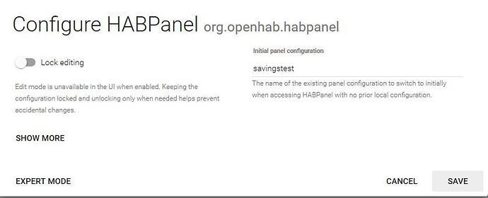

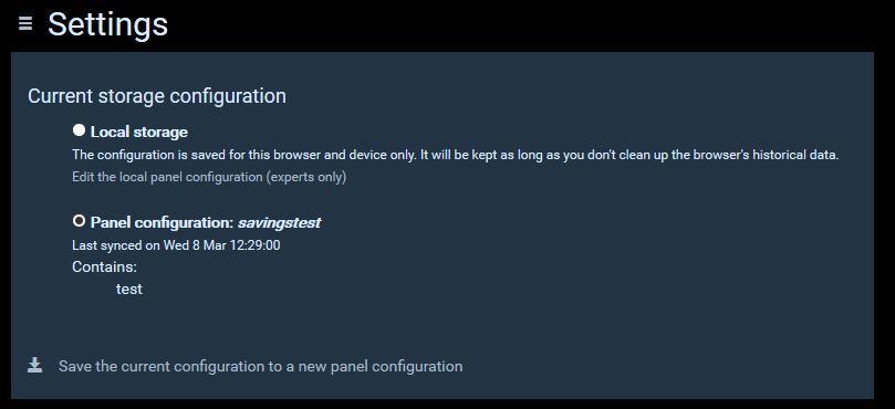

Maybe. I have never used HABPanel before, but did a short test and it worked:
On the computer where you want to save the config:
Go to your dashboard config and hit “Save on the openHAB2 server when done” , then click “Advanced settings”
On the left hand side choose the second option “Save the current configuration to a new panel configuration” and define a name.
On the computer where you want to load the dashboard config go to
PaperUI → Configuration → Services → UI → HABPanel → Configure
Type the name you saved your dashboard config with at “Initial Panel Configuraton”, then hit “Save”
Open HABpanel
http://192.168.2.237:8080/habpanel/index.html#/
and voila, you have your saved dashboard available.

Ok, thanks, now it works.
I think the error was, i named the panel to “Home test 1”
Now i tried only one word without spaces → “test” and it worked.
