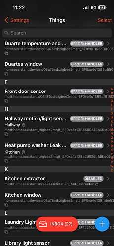

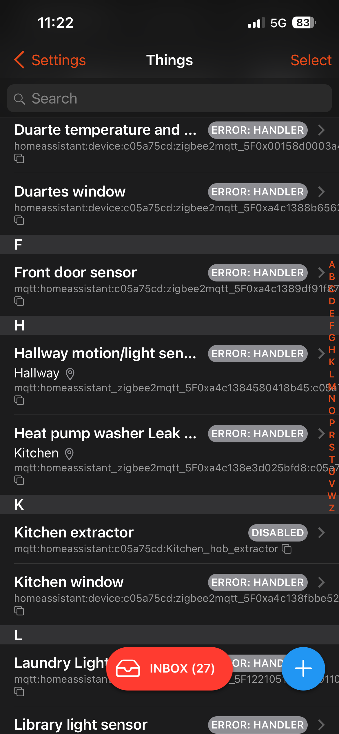

So right now I have about 30 things that are complaing about the home assistant binding:

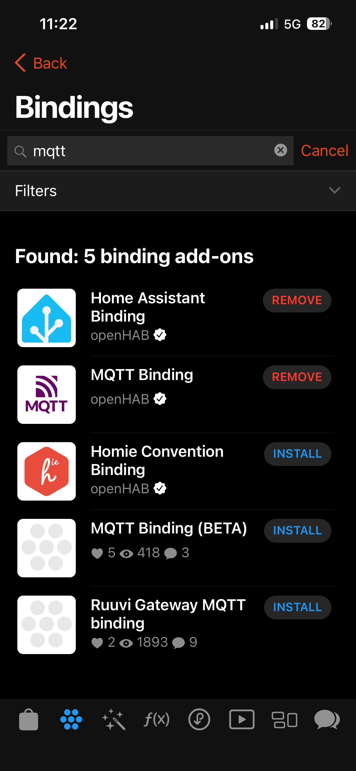

But I believe that everything is installed:
The binding says “waiting” in the karaf console and starting or restarting does not change the status.

Just guessing, but “waiting” is the problem. I know that the HA binding and the MQTT binding were separated not long ago. Maybe there was some script that ran in the background when that happened that was affected. Did you try deleting both, then adding them back?
EDIT: Also recall some HA issue with naming. See from the picture 27 things in the inbox. Is that normal?

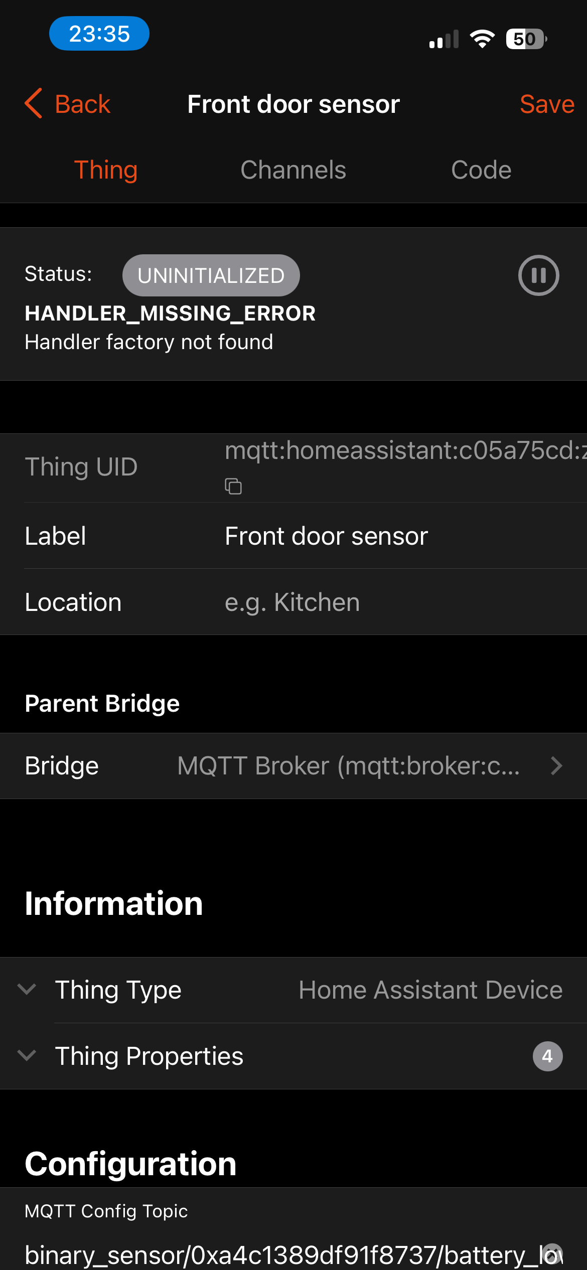

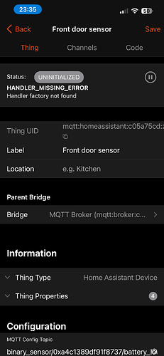

Status:
UNINITIALIZED
HANDLER_MISSING_ERROR
Handler factory not found

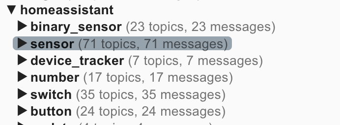

Do you still see the discovery messages under the homeassistant topic in MQTT Explorer?
Like
