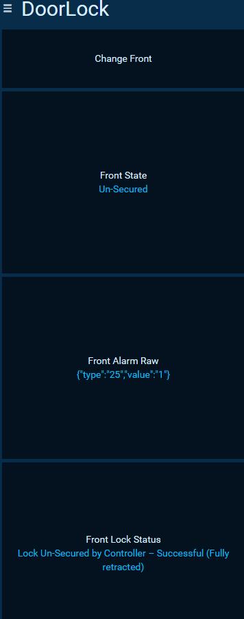

Here is the Habpanel widgets for the B&D lock. Actually, below the screen is the battery report but we don’t need that,
The first widget (Change Front) will send a command for the lock to change state when clicked. It uses the item:
Switch Front_Lock_Door "F Lock State" <door> {channel="zwave:device:fe40ab17:node32:lock_door"}
The second widget (Front State) is a very compact one for use on a cellphone. It corresponds to an item:
String Front_Alarm_Virtual_Short "FS State"
The third widget (Front Alarm Raw) is the alarm_raw straight from the z-wave and corresponds to the item:
String Front_Alarm_Raw "F Alarm Raw type" {channel="zwave:device:fe40ab17:node32:alarm_raw"}
The fourth widget (Front Lock Status) translates the alarm_raw to the full text from the manufacturer or whoever. It corresponds to the item:
String Front_Alarm_Virtual "F Lock StateV "

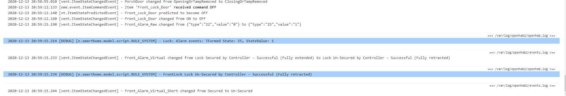

Now, I clicked the Change Front switch which caused the following log entries:
The first line is left over from something else.

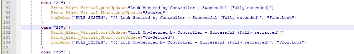

Here is the pertinent section of the B&D rules file to work in parallel:
The log entries from the second, third and fourth line show the progression of the Change command.
The fifth line of the log shows the Alarm_Raw changed, to {“type”:“25”,“value”:“1”}. When it hits the rules file it causes the first blue line in the log, then the next log line comes from case “25”, first line and is the text for the fourth widget followed by the second blue line which is caused by the, logDebug… line. Then the last line which is for the second widget.
This is what happens when the rules file works and this is the resulting UI:
