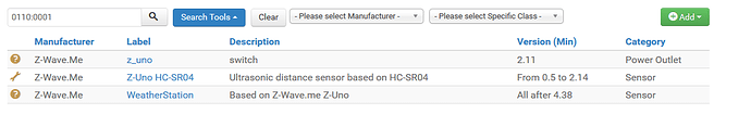

The database found it listed as a zwave.me device and they tend to reuse ID numbers

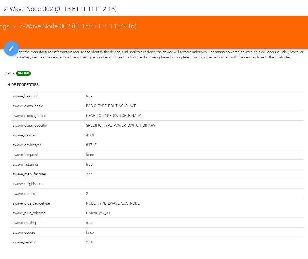

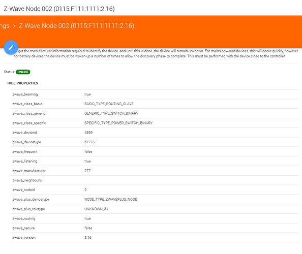

Just received new revision RS-10PM2 and try integration with Openhabian / RaZberry add-on (via z-wave biding 2.5.1). It was included in Z-wave network as unknown device. I suppose that device should be added to Openhab database first, but could not find generated .xml file for it. Here is device properties:

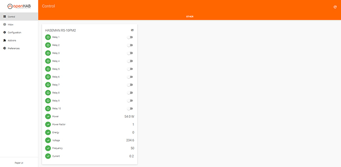

then include device within Z-Way network and enable Z-way biding in OpenHab, device appear with all channels. Here is the result after linking and rename things:
I will try to give some hints, but could you share little more.Where do you face issue? Please be advice that in order to use Z-way biding, you should have as Z-wave controller either Z.Wave.Me. Razberry Add-on or UZB+lic. If it so you should install Z-Way on top of Openhabian, then go to Z-way Dashboard first ( http://lanip:8083/expert ). Here go to Network / inclusion process of device ( if it was previously included pass to exclusion first). After success you should had switches and sensors apear within Z-wave device tab. If passed this steped and device operate correctly here you could proceed to Z-way biding within Openhabian…
