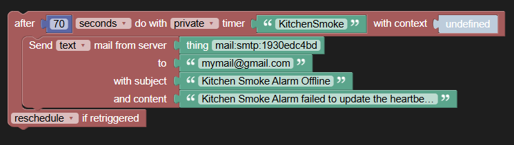

Running OH5.1.1 on RPi5 configured entirely with MainUI
My Zwave Smoke Detectors send a heartbeat message approximately every 60 minutes.
I’m trying to set up a timer that resets on every message and notifies me if the detector fails to send a heartbeat.
The trigger is every time the heartbeat is updated.
My timer looks like this bit it fails to re-trigger. What do I have wrong?
would you like to be regularly reminded of the existing sensor error? You can use the reschedule timer block to resend the mail every x minutes/hours. Until the error has been fixed.

Maybe I was not clear on describing my issue.
Rescheduling is not working the way I expected. The trigger is coming again before the rule ends, so I’m expecting the timer to be restarted.

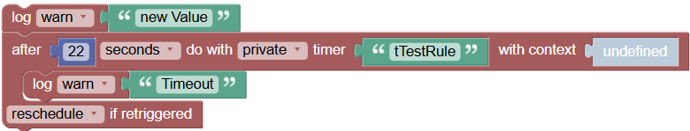

mmmh, will be restarted. Just tested again with a 20s trigger. At 22s only the first log comes and at a value below 20 s also “Timeout”.

thanks for confirming I was using it correctly
