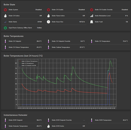

I have an OpenTherm Gateway connected to my Viessman combi boiler. Below is the data that it provides me with.
Furthermore I have a Heatmiser system controlling the Underfloor heating downstairs, and a Tado system controlling the radiator valves upstairs. These data are not shown in the screen shot

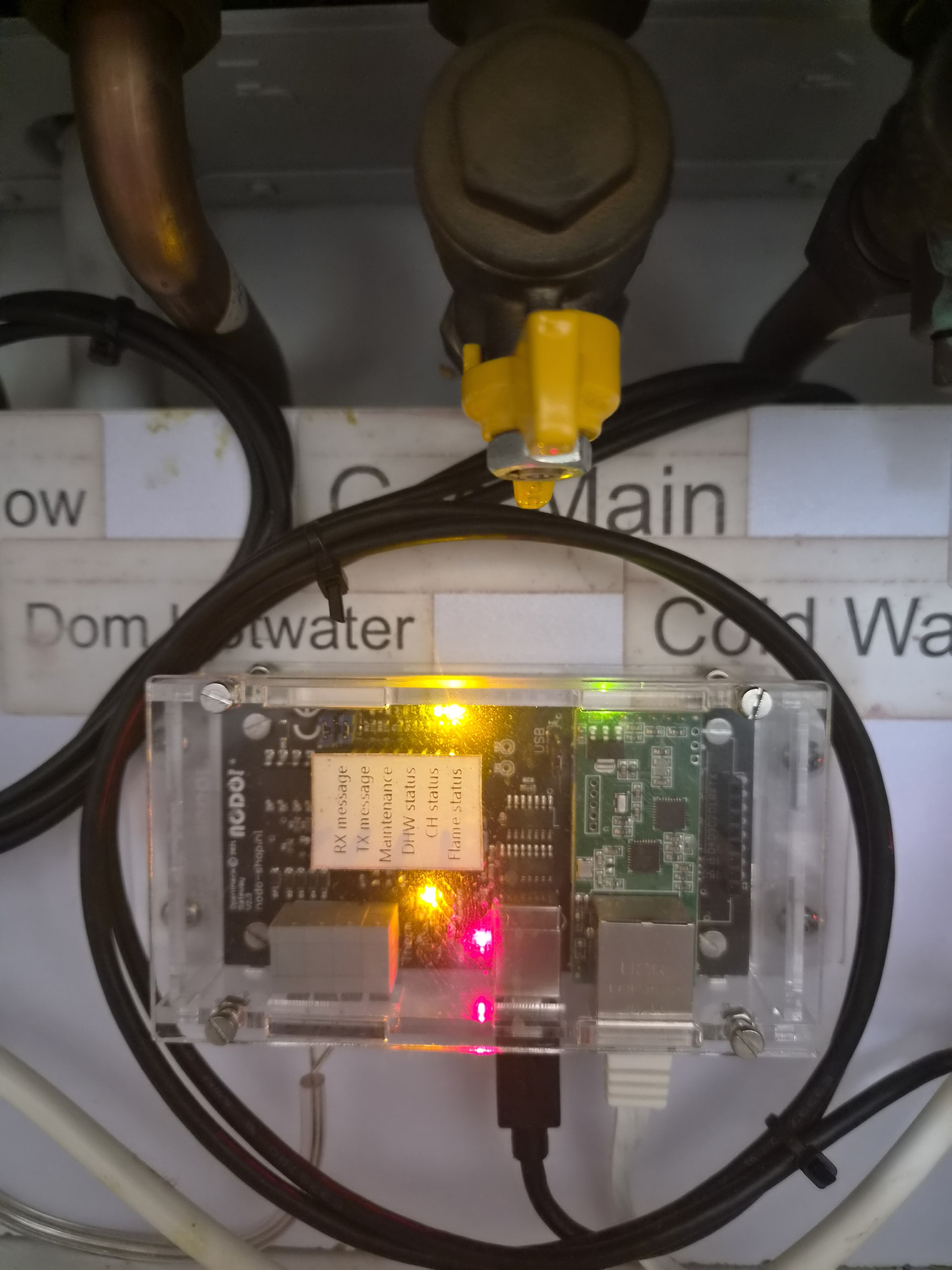

It is a custom Opentherm / Internet interface unit.
@andrewFG, Many thanks for the link. So am I right that you have constructed the Gateway referred to in the link ( Controlling the central heating system ). It looks a bit daunting for my skills. Have you any experience of the ready-made OpenTherm hardware from the Nodo Shop as an alternative?
My OTGW is from Nodo. Personally I soldered it up myself. However Nodo also offers a solder service for Euro 7.50

The OpenTherm Gateway route AndrewFG mentions is the most flexible option for monitoring, since it sits between the thermostat and the boiler and can pass everything through transparently. One thing to manage expectations on: OpenTherm itself mostly exposes temperatures, modulation level, flame status and a handful of fault flags, so it won’t give you the full manufacturer fault-code list. If your customers mostly run Vaillant, the openHAB eBUS binding can tap the boiler’s eBUS port and pull considerably more detail, including fault history, though it takes more fiddling to set up.
